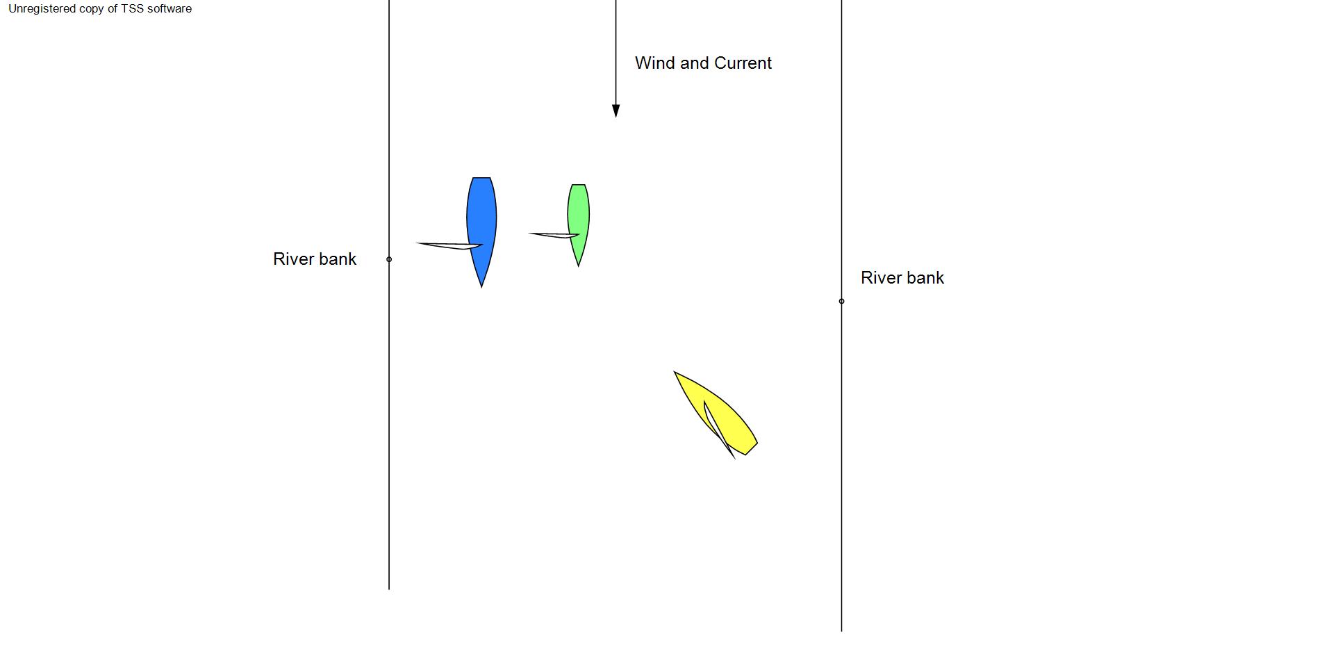

3 non-racing boats in a confined river - (diagram) - two on port running dead downwind and the third tacking upwind and on a collision course with the  boat in middle of river.  What should happen?

Starboard boat should tack back to the bank to get out of the current.

Post Options Post Options   Quote Brass Quote  Post ReplyReply Direct Link To This Post Posted: 17 Jul 12 at 10:28pm
Assuming IRPCAS apply.
Green and Blue shall keep out of the way of Yellow (IRPCAS rule 12(a)(i).
Yellow shall keep as near to the outer limit of the channel which lies on her starboard side as is safe and practicable. (IRPCAS rule 9(a)).
Yellow shall keep her course and speed (IRPCAS rule 17(a)(i)), but may, however, take action to avoid collision by ... manoeuvre as soon as it becomes apparent to her that Green (or Blue) is not taking appropriate action in compliance with these Rules (IRPCAS 17(a)(ii)).
Are Yellow's obligations in conflict?  Yes they are.  Life's full of little conflicts.
If these boats were racing one another, Yellow would gain a tactical advantage by crossing ahead of Green and Blue.  Since they are not racing, Yellow gains no advantage by pressing her right of way, and her best action is to tack back onto her own side of the river.

Post Options Post Options   Quote r2d2 Quote  Post ReplyReply Direct Link To This Post Posted: 18 Jul 12 at 9:48am
thanks for the replies
@ AlexM - yes you are right and actually the current was strongest on the side of the river where the blue boat was.
@JimC - well your reply made me look up the local navigation byelaws, which obviously I should have done before (doh!) and which state that colregs do not apply here.  The relevant bits of the byelaws seem to be:

There was no collision in the end but the problem arose because initially it seemed possible for green and blue to pass yellow on her port side but the wind dropped and green and blue slowed significantly.  So I am still not entirely sure what should have happened.
At the time it didn't feel right for green to head up towards yellow which left the option of green trying to squeeze through.

Post Options Post Options   Quote RS400atC Quote  Post ReplyReply Direct Link To This Post Posted: 18 Jul 12 at 10:29am
If they were racing, Green should have gybed onto starboard before yellow tacked.
You have to think ahead in river racing.
As it is a non-racing situation, green should have gone behind yellow. Blue likewise if she cannot safely pass ahead.
But Yellow could have hailed 'hold your course' and tacked, or just tacked to avoid sailing through the lee of the other boats. Or indeed hailed and luffed above them perhaps?
By thinking a little further ahead, yellow could have avoided the issue by making a short tack so that she did not meet the other boats on that side of the river. Thinking and judging things a couple of tacks ahead makes a lot of difference.
Post Options Post Options   Quote Rupert Quote  Post ReplyReply Direct Link To This Post Posted: 18 Jul 12 at 1:02pm
I'd agree these situations should involve common sense as well as rules. Chances are that it is easier for yellow to keep clear, simply by luffing or tacking, than for boats going with the wind and current.
Post Options Post Options   Quote JimC Quote  Post ReplyReply Direct Link To This Post Posted: 18 Jul 12 at 1:51pm
In that situation, were I yellow, I might either have tacked or else waved green to luff up and pass to windward of me.
Were I blue I think I'd have just held my course. I don't think there's much I could usefully do.
If I were green I think I'd probably have crossed the river to pass well behind yellow, starting a while before the diagram.
It depends hugely on precise closing speeds, wind and a dozen other factors. But the main thing is to act early and communicate as much as possible with the other boats.
With the navigation rules in question I would say that green is required to luff up and go behind yellow, and should have already started by the time the boats got to that position.

Post Options Post Options   Quote Ruscoe Quote  Post ReplyReply Direct Link To This Post Posted: 18 Jul 12 at 5:07pm
This is a common situation for us at Tewkesbury, our River is very narrow and racing is very, very close.  In that situation as yellow i would tack off despite having a starboard right of way.  Whilst Green looks to be easily comfortable to be able to luff up out of the way Blue may struggle.  In this instance at our club he could call for water for the bank if there was no other action he could take.  Hence why when i am in this situation i tack off for a clearer racing line and wind.
