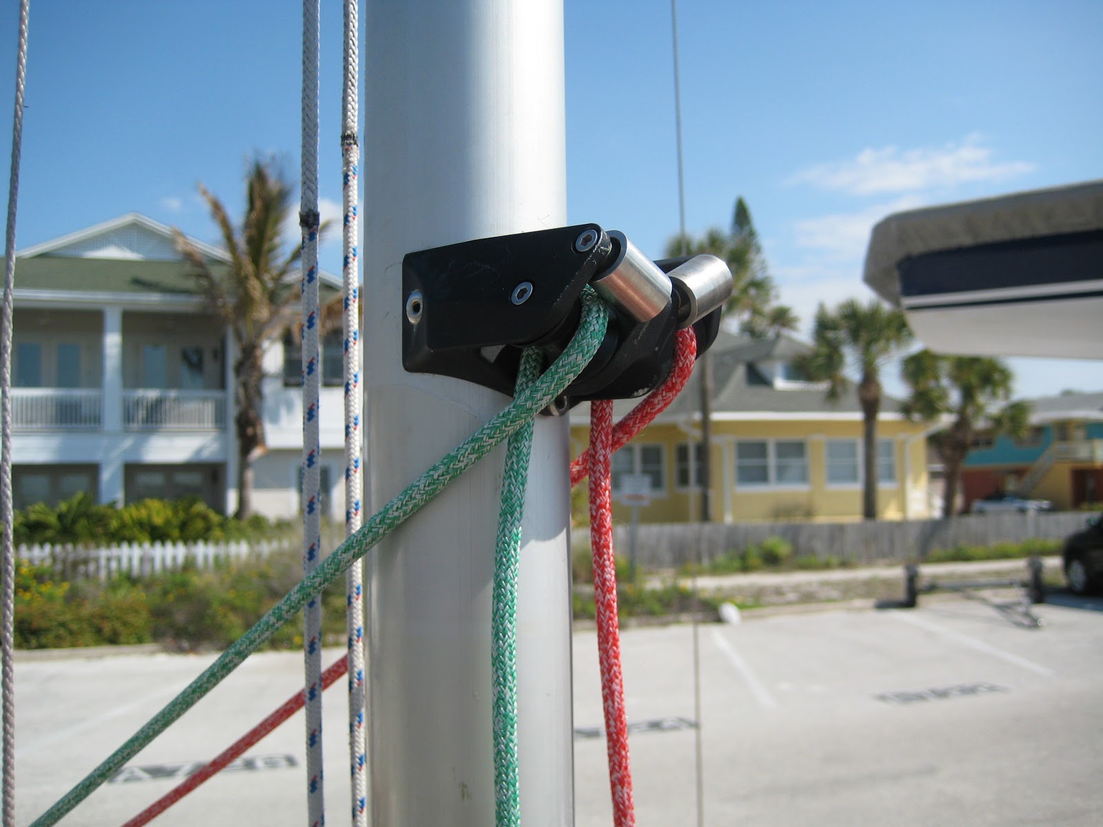

Very nice!  Even has port and starboard coloured launch ropes .... I guess launching the wrong pole is a sure fire way to go swimming!

Gybing with the twin pole integrated sheet and guy set up is ridiculously easy.
