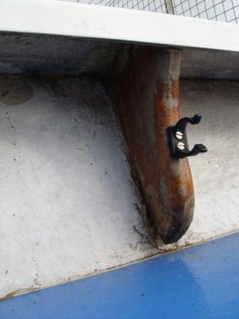

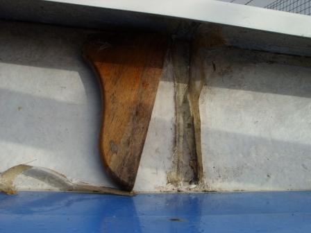

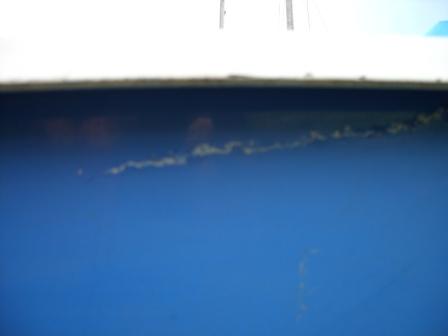

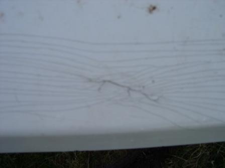

Thanks for the advice so far much appriciated. Had another look today and took some pics, also found that the fall has bent my starboard spreader
1. This shoulder has come clean away.
2, The Gunwale had lifted and sat on top of another Knee and caused a slit split to the hull near the the gunwale.
3. This knee is loose.
4. top of the gunwale in the damaged area.

Cosmetically I can't advise...
With the crack in the topsides you need to abrade the inner surface and put a glass patch over it. probably 4 layers of glass with the first one overlapping an inch from the last bit of crack and each succeeding piece say an inch bigger all round.
In all cases you need to make sure the surface you are gluing onto is well abraded and really clean. Acetone can be good to clear up the surface. Make sure your wood knees are well dried out before gluing too - airing cupboard?
