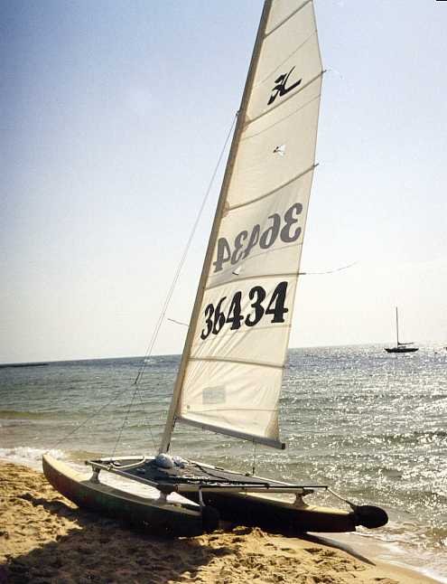

feva_sailor ![]() Really should get out more ![]() ![]() Joined: 03 May 06 Location: United Arab Emirates Online Status: Offline Posts: 767 |
try a hobie 14!brilliant!
