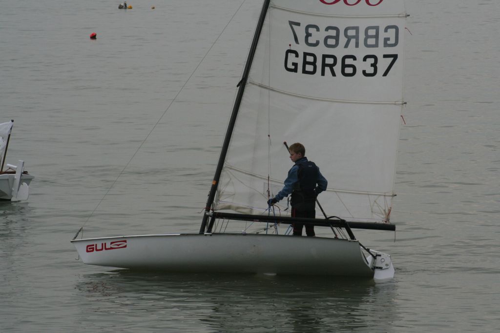

well i went sailing for the first time in my 600 today but as you can see......there was no wind lol! .  Didnt learn much but how to drift effectively! theres a load on how to tack and gybe here..........   http://www.superspars.com/RS600. html

about 53 on a light day and 55 after i've eaten .  But yeah i am kind of small but im fed up with hanging off a laser radial ina F4 and going nowhere fast while other people are just monstering it.  I wanted a little more speed for my effort input
