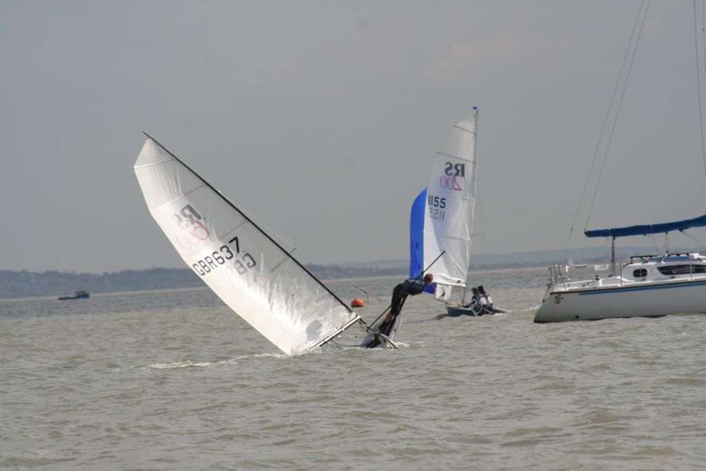

well i went sailing for the first time in my 600 today but as you can see......there was no wind lol!.  Didnt learn much but how to drift effectively! theres a load on how to tack and gybe here..........   http://www.superspars.com/RS600. html

Posted By: Prince Buster
Date Posted: 16 Apr 06 at 10:12pm
nah i played around on my friends one for a while before i got 637 and i was fine with the big rig most of the time!

Went sailing again today...bit more wind but also a bit more time in the water
Was it fun.......hell yeah!
Posted By: Femto
Date Posted: 17 Apr 06 at 6:04pm
Just a quick observation, its REALLY important to get the main right to the top of the mast. If the main halyard cleat slips, it needs replacing. There are a few tricks like using the cunningham on the halyard to pre-tension it.
Also looking at those photos, more cunningham and kicker!!!!!!!!!!!!
Oh and regards tacking, yes its a black art- most people struggle and it seldom looks pretty!
RS600 717, RS400 870 Netley SC

Posted By: carshalton fc
Date Posted: 17 Apr 06 at 6:09pm
give the poor guy a rest it was his first go out in the boat and the sail looks fine.  why would u wont more cunno and kicker?

Posted By: Femto
Date Posted: 17 Apr 06 at 7:14pm
Only trying to help!  Using more cunningham and kicker makes the sail shape more stable- when u dump the main, it depowers rather than all the power going upto the top corner.
Date Posted: 17 Apr 06 at 7:17pm
yer but when going down wind which thats what the first pic looks like u dont want any controls on cos no need,
Date Posted: 17 Apr 06 at 8:22pm
Nah leave it out Luke, he's only trying to help!
Thanks Femto ill bear those points in mind next time i go out for a sail.
Posted By: Guests
Date Posted: 17 Apr 06 at 9:26pm
Actualy luke in the 600 ive found the kicker tends to give the sail a much better leech profile especially on reaching, not to mention making the main significantly easier to play.  Although my personal preference similarly wouldnt be to have any significant downhaul tension on.  But then saying that, ive only used the diddy rig once so im not really sure how to best sail with it.
And in reference to tacking, its much much easier to tack with minimal kicker on but i would say try this to get used to tacking and then as u get more confident, progressively pull more and more kicker on.  But then Thats just how i got started, not too sure if its the best way of going about it.

Prince - loving the look of terror on the left hand photo!
