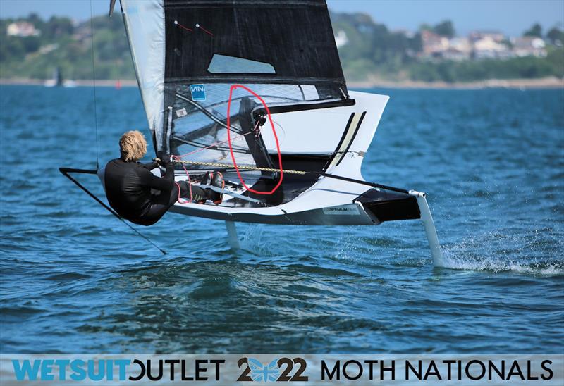

Very much enjoyed the reports and photos, and amazed at the lack of DNF. Seems like they have become a really mature product with some excellent sailors. What’s the bit in this photo? It looks much to wide to just be seam tape and appears to stick up above the boom.

I think that is just cloth, same as the cloth used in the main body of the sail. It goes either side of the boom and meets above where the sail returns to single ply.
Brad Funk has the same arrangement here but with the angle you can see a little better what is going on. Talking to Mike quite a lot of work goes in to the battens in this area to keep the cloth smooth around the boom and support it down to the deck, but also allowing for significant movement of the sail relative to the boom with changes in control lines
