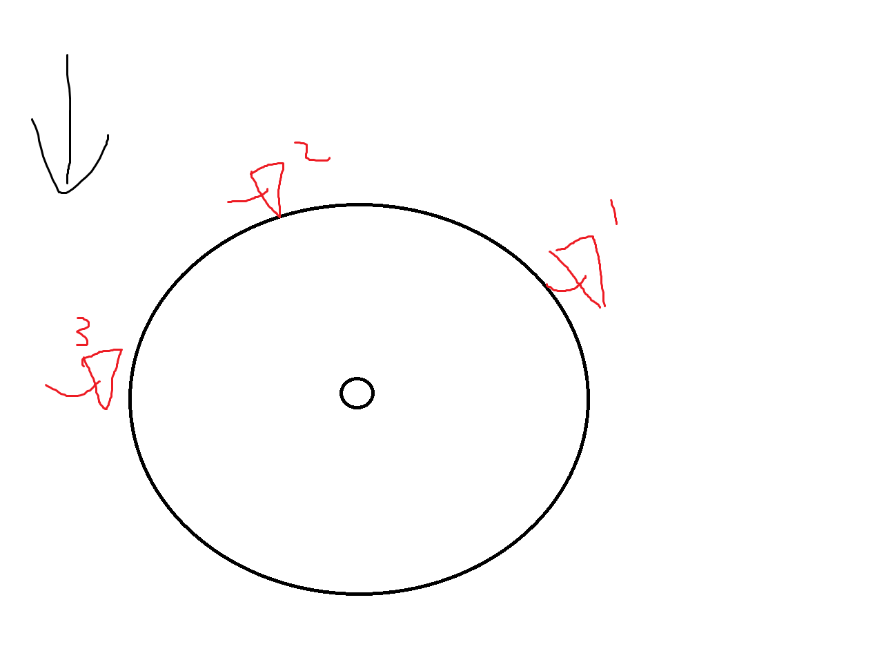

It mostly looks very promising to me. There does seem to be a potential game change I don't like - If I understand the material correctly, in the event that a boat clear behind reaches the circle before a boat clear ahead then the boat clear behind gets mark room.
Two reasons why I'm unconvinced, firstly that in practice its a very difficult call to make as to which boat reached the circle first, and secondly there's no real last point of certainty possible. It would be an unusual possibility, but I would be very interested to know why its considered better than the current situation that a boat which isn't overlapped never has mark room. |

I presume on the current rule it doesn't specify that its only when the first boat reaches the zone. Only when overlapped, which they clearly aren't? After reading all of this I couldn't tell you why I thought with the current rules 1 would be entitled to mark room from 2 but 3 wouldn't be entitled. I've just always thought they were Other than that I thought it was definitely easier to apply the rules on the test compared to the old one. ![]() Edited by ClubRacer - 25 May 22 at 6:04pm |

Personally I would have the whole rule re-written based on a flowchart or something. I have seen confusion at a leeward mark between asy boats entering the zone from the sides and blow-along boats entering from the top. People's honest, sincerely held beliefs about the sequence of events are often quite different, because they view from different points. Applying the rules is the easy bit sometimes. I suppose it's a big ask to expect the same rules to work well for skiffs doing 20 knots and mirrors struggling to stem the tide.

If I was boat 1, I would go another boat length, then gybe and blast the for the mark, gybe again for port rounding, sure to beat 2, give 3 a bit of a fright, but should beat her.

I was mainly looking for what the current rules are for boats 1 and 2.
My understanding is that in the proposed new rules that 1 would have to give room to 2 (a) When the first of two boats reaches the zone, (1) if the boats are overlapped, the outside boat at that moment shall give the inside boat mark-room. (2) if the boats are not overlapped, the boat that has not reached the zone at that moment shall give the other boat mark-room. They clearly aren't overlapped because 2 is clear astern of 1 at the point 2 reaches the zone. My confusion is on the current rules. It sounds as if with 18.2b that even if boat 2 was half way into the zone but 1 is still clear ahead as it reaches the zone 1 is entitled to mark room. I think in the real world you wouldn't see this scenario as 1 would just gybe heading for the mark and be overlapped anyway, I'm just curious on how to apply the rules here correctly. Edited by ClubRacer - 25 May 22 at 7:49pm |

AIUI with the current rules boat 1 gets mark room from 2 & 3, being clear ahead when a boat reaches the zone, and boat 3 gets mark room from 2.
If I understand the experimental rule correctly then boat 2 gets mark room from 1 & 3, and boat 1 mark room from 2. It would be interesting to hear the logic, and also how the last point of certainty principle would be handled, since I should have thought it rather hard to judge which boat had entered the zone first with widely separated boats like the sketch. We do need to remember, though, this is just a test rule, its not even got as far as being a proposed change. |
