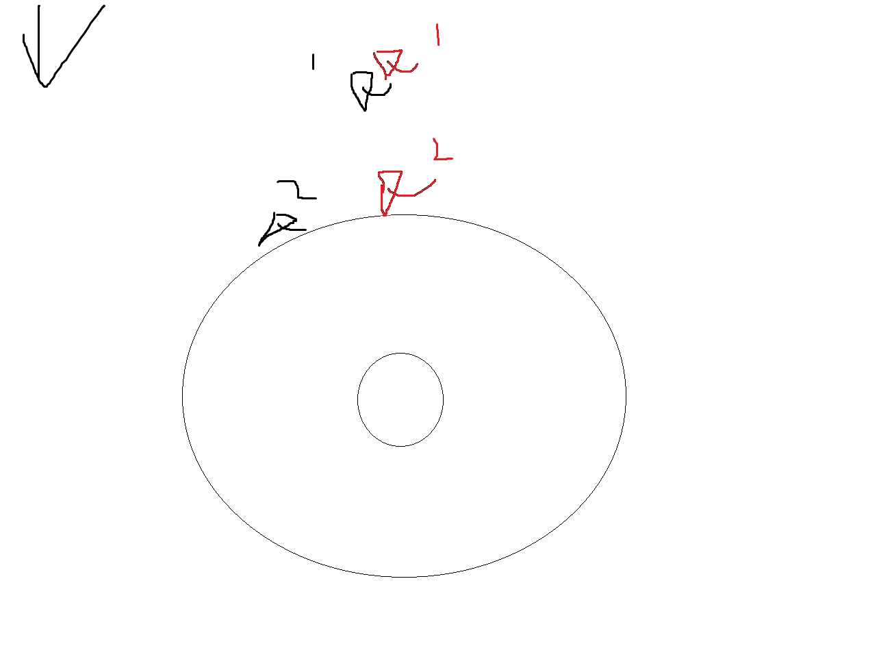

In that drawing, if marks are left to port, 1 will bear away around about the edge of the zone, either creating an overlap or reasonable doubt.

If I was boat 1, I would go another boat length, then gybe and blast the for the mark, gybe again for port rounding, sure to beat 2, give 3 a bit of a fright, but should beat her.

I was mainly looking for what the current rules are for boats 1 and 2.
My understanding is that in the proposed new rules that 1 would have to give room to 2
18.2  Giving Mark-Room
(a) When the first of two boats reaches the zone,
       (1)  if the boats are overlapped, the outside boat at that moment shall give the inside boat mark-room.
       (2)  if the boats are not overlapped, the boat that has not reached the zone at that moment shall give the other boat mark-room.
They clearly aren't overlapped because 2 is clear astern of 1 at the point 2 reaches the zone.
My confusion is on the current rules. It sounds as if with 18.2b that even if boat 2 was half way into the zone but 1 is still clear ahead as it reaches the zone 1 is entitled to mark room.
I think in the real world you wouldn't see this scenario as 1 would just gybe heading for the mark and be overlapped anyway, I'm just curious on how to apply the rules here correctly.
If I was boat 1, I'd have gone 'right hand down a bit' swinging my transom around to put 2 in an overlap and demanded mark room. If I was surely clear ahead, I wouldn't be off over there in the first place? If you're steering to miss the mark by 3 boatlengths for no immediate reason, what are you expecting to happen?

AIUI with the current rules boat 1 gets mark room from 2 & 3, being clear ahead when a boat reaches the zone, and boat 3 gets mark room from 2.
If I understand the experimental rule correctly then boat 2 gets mark room from 1 & 3, and boat 1 mark room from 2.
It would be interesting to hear the logic, and also how the last point of certainty principle would be handled, since I should have thought it rather hard to judge which boat had entered the zone first with widely separated boats like the sketch. We do need to remember, though, this is just a test rule, its not even got as far as being a proposed change.
Posted By: ClubRacer
Date Posted: 25 May 22 at 10:05pm
Interesting that I've never considered the outside boat to get mark room while being the outside boat purely by being clear ahead.
Tactically if you were overlapped outside approaching the zone you could head up massively to ensure you're clear ahead, all be it not heading anywhere near the mark.
Here boat 1 would get mark room from 2?
