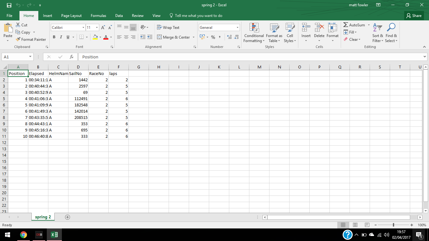

ClubRacer ![]() Far too distracted from work ![]() Joined: 26 Sep 15 Online Status: Offline Posts: 210 |
thats what the csv file looks like,
![]() writing a sum is only good if all cells in that column need the time reduced or they're grouped together im currently already deleting the ones that aren't needed for the designated finish and reversing it for the 2nd one

GML ![]() Groupie ![]() Joined: 24 Jul 11 Online Status: Offline Posts: 94 |
As JimC says, just upload the raw results into Sailwave and split the fleets there.
Yep, I just checked it works with data like yours.
Import the elapsed times as being finish times (right click on the field during the import process lets you do this). The edit race and put in two starts, one for 12:00:00 and one for 12:05:00. If you don't have a field you can use to set the start from then you'll have to put one in. Then Sailwave should do everything else. |
