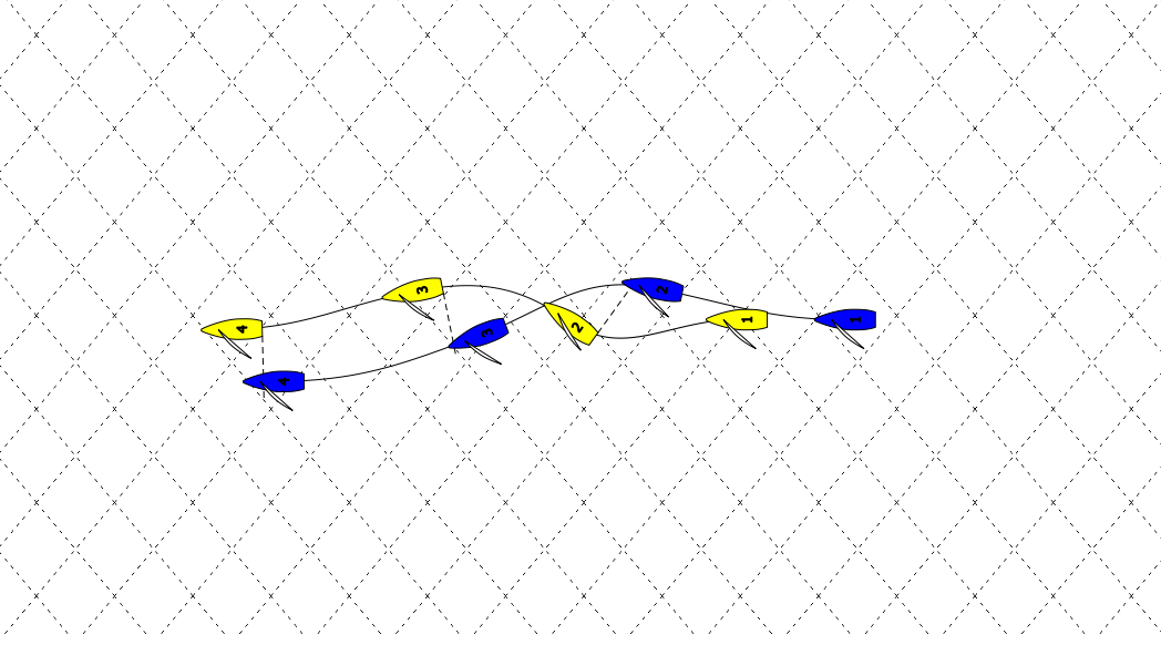

Post Options Post Options   Quote Presuming Ed Quote  Post ReplyReply Direct Link To This Post Posted: 18 Dec 12 at 10:49am
Originally posted by jeffers
As for right and wrong in this case I would not like to call as I thought that if you acquired right of way because of another boats actions (which happened in this case) the requirement to keep clear was always firmly on the boat that bestowed the right of way? I do not have a rule book to hand though so i cannot quote the relevant rule number.
If you sail from clear astern to leeward means you change from give way to right of way thanks to your own actions. therefore 15 applies to you. If you establish the overlap within 2bl, leeward can sail no higher than her proper course.
If the initial situation as described by the OP is something like this, then yellow is subject to 16.1 during her luff, and as described above, blue is constrained by 15 &17 after she establishes the overlap to leeward.
