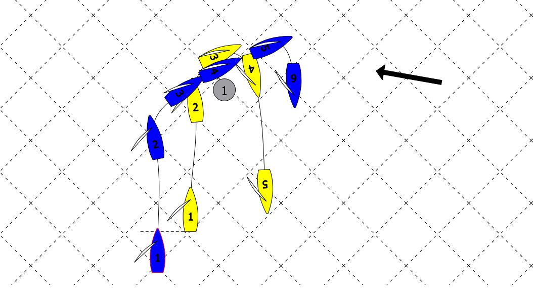

i will try to use the software to show positions but I was 'overlapped to windward and on the indside 'as I approached the mark and the mark would have been alonside my staboard side amidships as I existed the tack on port
Posted By: Simon368
Date Posted: 17 Dec 12 at 9:17pm
like this:

Still at the mark. Ping blue for not giving mark room.

The issue is not whether your were 'at' the mark (which on your diagram, I don't dispute you were).  On my analysis, as you originally described it, once you passsed head to wind, rule 18 went off in its entiriey.  I agree with PEd that, as diagrammed, S had already failed to give you mark-room before you luffed and passed head to wind.
I agree that @3.5 B is not giving mark-room, and that, Y is entitled to luff as hard as she likes, as long as she does not pass head to wind.
@4, Y is past head to wind, rule 18 is off, and B breaks rule 16.1.
Yellow is overlapped inside to windward. Defn of mark room includes room for inside boat to tack. Yellow has right to tack and sail proper course at mark.

If the initial situation as described by the OP is something like this, then yellow is subject to 16.1 during her luff, and as described above, blue is constrained by 15 &17 after she establishes the overlap to leeward.
2bl

Originally posted by Simon368
There was no doubt I (the Lightning) was at the mark as with the tide pushing me up against as I rounded i was to intent on watching whether I had cleared it to notice the Steaker until he shouted. Because the wind was at approx. 90deg to the course my action was to sail slightly passed the mark (to allow for the light wind and tide) and put in a tack and head back the direction i had come from. If I was at a leeward mark and hardening onto a beat I would hold my hand up as wrong but my 'proper course ' was to tack an head back up river. At the point of the incident i doubt that even 50% of the Streaker was alonside the mark.
The fact that the Streaker immediately tacked after avoiding me evidence of this?
This is precisely why you should have taken it to protest, informal of course over a couple of beers and your local rules guru. That way you can get 'facts found' and both of you know what to do (or not do) if this happens again.
It is impossible to interpret on the internet as both sides have a different story and each seems valid in this case.
Were I asked to sit on a PC for this it would have to come down to facts found, you extrapolate forward from there.
Posted By: ohFFsake
Date Posted: 11 Jan 13 at 12:40am
Facts found?
Both parties seem to agree that at the point Y tacked onto port he was clear ahead of B. Therefore rule 18 ceases to apply as Y can't go past head to wind unless he is overlapped inside at that time.
So regardless of proximity to the mark it is surely a fairly simple Port v Starboard?
But not that simple...
B admits that he went wide and then headed up whilst clear astern in order to make a tight mark rounding. It seems to me that the timing of this with respect to the tack by Y is the crux of the issue. If at the point Y tacked he was able to keep clear of B on his course at that time then surely any subsequent alteration of course by B that leavecs Y unable to avoid him is B's fault?
But if B tacked later, ie after Y's course change, then he's at fault, and if he wanted to have room to tack under rule 18 should have slowed down earlier to force B outside and ensure he was still overlapped at the point he passed head to wind, as mentioned earlier.
