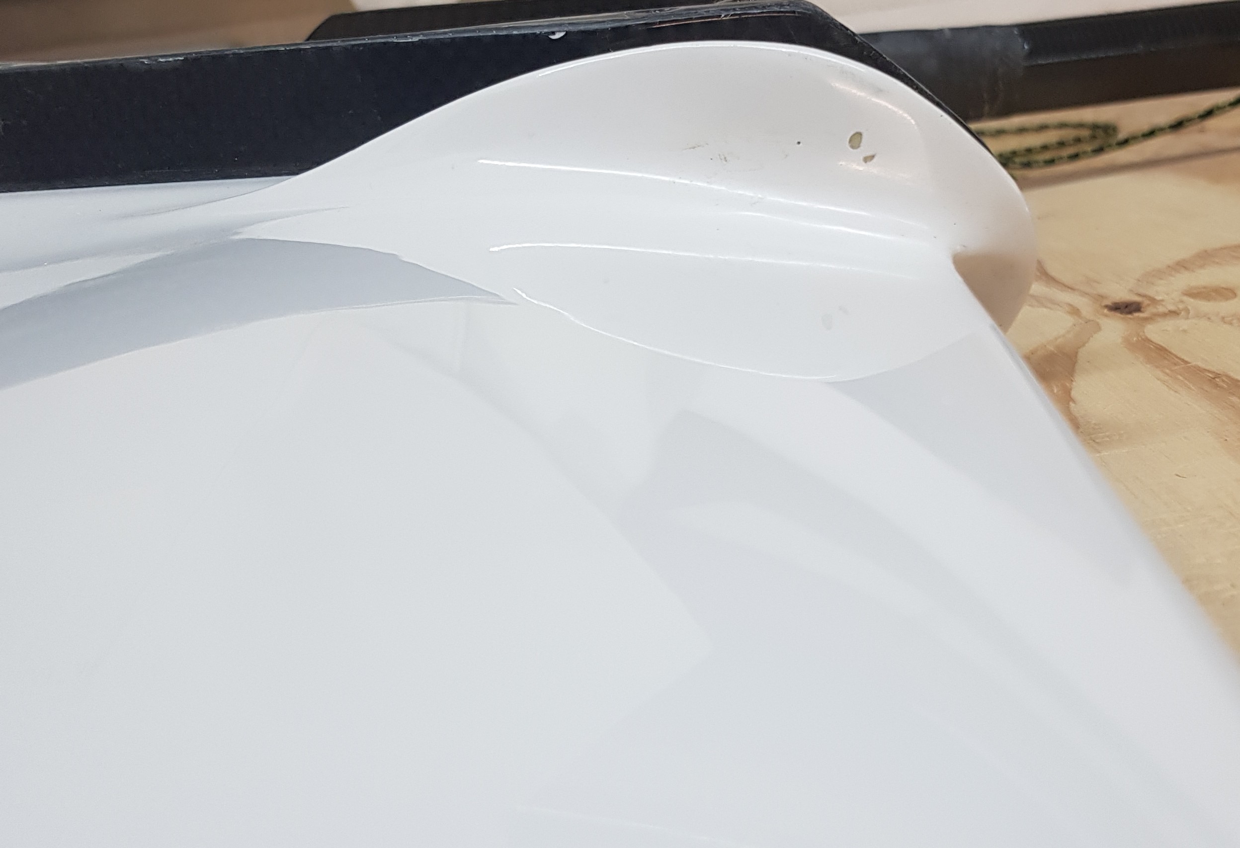

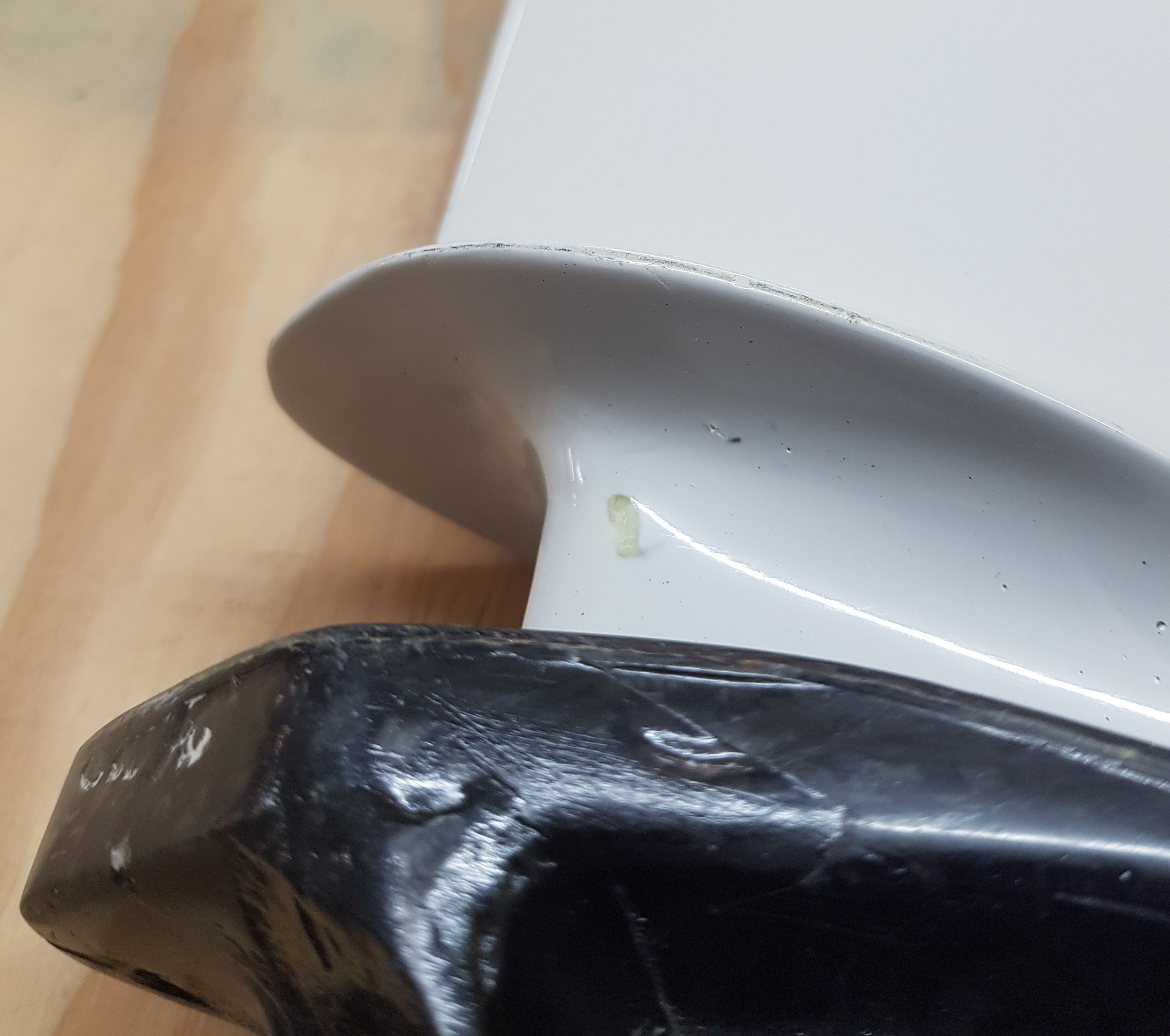

So this fence isn't producing lift? It isn't shaped to change the flow of water around the foil? Canting / lifting the rudder doesn't increase our decrease the angle the fence makes?
Having a fence doesn't enhance the performance of the foil in certain conditions, i.e. it stops ventilation, stopping the stalling of the higher aspect foil?
If I make this fence larger when does it become a non allowable wing?
Cheers you

Can't see it clearly on phone, but it looks like it also as a reduced chord ?
If the manufacturer designed blade purely to reduce suction and you attempt to make it into a foil ! Speaks for itself.

Not attempting to make it a foil.
If it reduces suction is that no creating lift?
Cheers you

That's too say, if this fence is creating any lift around it then it is a wing it contrivance under the definitions of the ERS/rule?
IF NOT.
then how much wider/ bigger can it get before the lift it generates is a wing or contrivance?
Cheers you
only me from over the sea......

I'm not and have never been an official measurer for any class, but I have been involved in contributing to class rules for Cherubs and ICs. So take that for what its worth.
If I were looking at a Merlin I would say that a fence becomes a foil when it has any lifting capability, and most especially if there is any control capability of changing the angle of incidence. So if its a small structure not extending beyond the likely boundary area of the flow round the blade, with a symmetrical section oriented as close as possible to the likely local water flow its a fence.
[snip]
[later]
I've just looked at the rudder designs posted on the Merlin forum. I note
- structure which doesn't appear to extend beyond the boundary layer
- very low aspect ratio so very high drag if generating lift
- small total area
So unless there is some gear on the boat for changing the angle of incidence then I'd be quite happy with those - again for what little my opinion is worth.
In practical terms there will be a gap between a fence that is bigger than it needs be to do the job, and a foil that's too small and too low aspect ratio to do anything significant. The difference will be obvious. But in any case any control to accurately change the angle of incidence of the foil on the water would be a dead giveaway.
