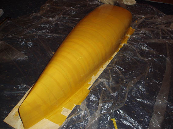

Bare hull without a deck came in at about 250g but im going to need a bit more structure inside to make up for the lack of compound curvature.
Having poped this hull I think id add in a balsa core for a bit of extra stiffness if I do anything like this again.
Target weight for an IOM bare hull and deck is around 500g from what I can make out

Post Options Post Options   Quote tgruitt Quote  Post ReplyReply Direct Link To This Post Posted: 21 May 08 at 1:32pm
Originally posted by Isis
Yep, thats the mould just prior to laying up the hull which is
vac-bagged glass and epoxy.The hull came off yesterday a tad heavier than
hoped. Deck mould should be done in the next couple of days.
How much is a tad?
Isis View Drop Down
Joined: 01 Sep 05
Posts: 2753
Post Options Post Options   Quote Isis Quote  Post ReplyReply Direct Link To This Post Posted: 21 May 08 at 1:23pm
Yep, thats the mould just prior to laying up the hull which is vac-bagged glass and epoxy.
The hull came off yesterday a tad heavier than hoped. Deck mould should be done in the next couple of days.

it's parcel tape over a male mold.

what are you building it in? that looks like paper.

Right on the model yacht but its not a uni project... 1m long, over 30cm wide with half a square metre of sail and movable balast... should be light too: aiming for 3kg all up.
