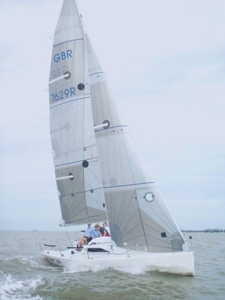

I mentioned weighed in at 1455kg and someone said it would make a big difference.  It really has and rating is 0.954 from 0.968. I will post certificate when I get home. I run a 140% genoa &  40.5m2 kite. Main is fairly small as on pic, little roach.

14points!  i seriously need to get pj wieghed!
picture isnt working

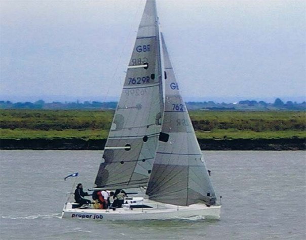

a couple of shots from last season
