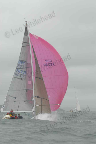

Post Options Post Options   Quote Oli Quote  Post ReplyReply Direct Link To This Post Posted: 20 Feb 09 at 5:02pm
nice!
