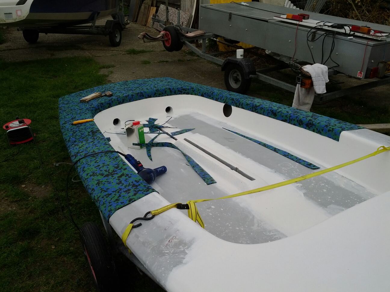

I have begun the gripping of the contender today, note the hair dryer to activate the adhesive and also to help get it to curve round those tight corners.

This is a closed cell EVA foam, not strictly pro grip, but £10 a sheet rather than £30
It doesent "soak up water" as many seem to think, it will absorb a small ammount through use but not more than a few grams over that area. Ill setup a new thread with a few more photos. Dan |

Dan, can I ask where you got the sheets from please? I had a look on Algeos website but couldn't seem to find anything other than insoles for orthapaedic shoes, and I'd need a few of those to do my cockpit floor! |

If it's for your 300 consider using surf wax. My 300 cockpit was coated with it when I first got it and I've continued to use it. Very good and much easier than progrip etc. Can look a bit grey and grubby though.
Progrip is better at hiding things though ;-)
