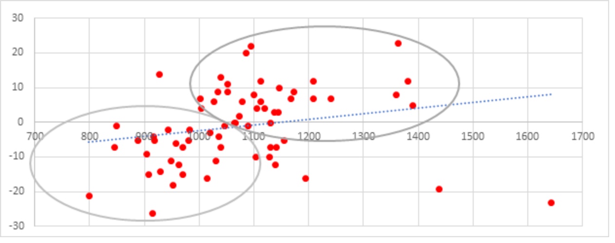

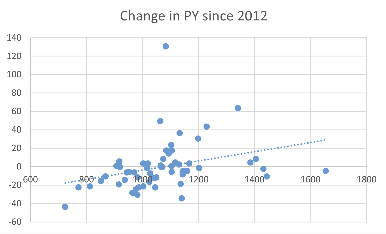

I really suspect that the 'Fast boats getting faster' element is dramatically skewed by the I14 and the Moth which, well, really are getting faster.
The slow boats getting slower, well - I suspect that is skewed by the junior classes. Case in point being the Topper which I believe was 1290 when I sailed one (V competitively) in roughly 2009-2013 and at that was already a benefit in strong airs, with multiple club race wins against exceptionally good sailors I really shouldnt have stood a chance against. It's now up to 1365. Is this because the boat has changed? Well, it's only sped up with the advent of decent 6:1 downhauls, a more powerful 6:1 kicker recently, and little reliability improvements (gooseneck, gudgeons, masthead) in that time, so that's a cold, hard, no. So, what's more likely being handicapped is the standard of sailors racing.
There has been a genuinely massive speed increase in the Streaker and Solo at very least with the advent of decent FRP boats since ~2005 or so, probably 15-20 point based on personal experience with a pretty good (154*) wooden Streaker, followed by an FPR rocketship (183*). The difference was all downwind, with the woodie faring excellently upwind, but sticking like sh*t downwind. So in this case - has the standard of sailor changed? Well, probably not, it's still a similar demographic of mainly old blokes with mainly current boats. What's changed, is the current boats are faster than they were 15 years ago.
IMO this demonstrates the crux of it is that what is being handicapped is a composite of: the boat speed itself, and the skill level of your average standard club racer
  • In some classes, the standard of club racer will be high as people will religiously race at their own club as training and the boat is a real all rounder (Think RS300, Enterprise, GP14, Albacore, RS200). This potentially makes the handicap go down in number, as they are some of the 'best' sailors consistently club racing and as such the handicap can only be met by the best in class.
  • Other classes will attract only elderly, non-open meeting sailors who potter round at the back of the fleet (Think - at risk of offending people - Comet, Wanderer, RS Vision, RS Quest), and as such the best in class is sort of adequate at best, in overall terms. In these classes, a 'good' sailor may be able to overachieve in handicap racing, as the handicap of the class has been dragged down over the years by substandard sailing.
  • Other classes - the good sailors will not consider club racing worth their time as it's better spent 2 boat tuning or with a coach (Think top level Laser Radial/Nacra 17/29er/49er sailor), which means that the PY may go up, or at least not be reflective of the best in class, as the standard of club racer is not representative of the actual top sailors in the fleet
  • Other classes will suit only class racing for the top sailors, and PY becomes pretty irrelevant as the top boats will be racing in fleets of their own (Think Merlin Rockets at Salcombe, or I14's at Itchenor or wherever their current hotspot in the Solent is)
  • Some development classes will have PY returns for boats of varying degrees of competitiveness (Think Merlin Rocket where everything from NSM's to Winder's is beign club raced, or National 12's where the DCB's and Crusaders alike are being club raced) which could lead to a handicap that favours newer boats but punishes older ones.
  • Or finally club racing doesnt suit the boats needs/strengths (Think I14/Moth/49er/Cherub, where a long ww/lw course is desirable to stretch the boats legs, and this is not always available), which will mean limited returns are available, and the Handicap is very much speculative/non existent/inaccurate and in these cases, either a win or loss is often attained by a significant margain.
This is all speculative, and I've barely fact checked the above, so feel free to throw some numbers/facts/abuse at me and tell me I'm wrong. Does anyone have a freely available archive of PY numbers from 2000 to 2020? Would be curious to see them and make some graphs myself if so, and I don't mind what format they're in!

Could it be that since the advent of the computer system, rather than somewhat static returns from clubs, we are seeing trends far more clearly than in the first 50 years of yardsticks? For the first few years we were seeing adjustments to reality, but that period should have passed by now.
Some boats, which have fallen from grace, can easily be explained. For most others, blaming the helms or the weather seems too simplistic.

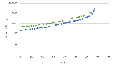

If laser and solo results disproportionately affect the statistics eg they provide say 25% of the data points, and the system is set up to equalise and for every dog to have its day.  And my class has only 0.5% of the data submitted....
Then should I not expect either a laser or solo to win 25% of all races then held as they are providing more competitors?
Or having given the best data they can, should my 0.5% class win a disproportionate number of races?

There are definitely windy years and quiet years, even, when I did some simple research, windy decades and quiet decades. I noted that in quiet decades you'd get classes voting for more rag. Reckon the last few years have been windy, but that's gut feeling, I haven't done the research, so very easily could be wrong.
I do think it possible that the new results driven PYonline system could be chasing the weather to an extent, but unless it can be demonstrated that there are frequent transitions between windy and quiet years, which would require *serious* research, on the whole its probably as much a good thing as a bad one.

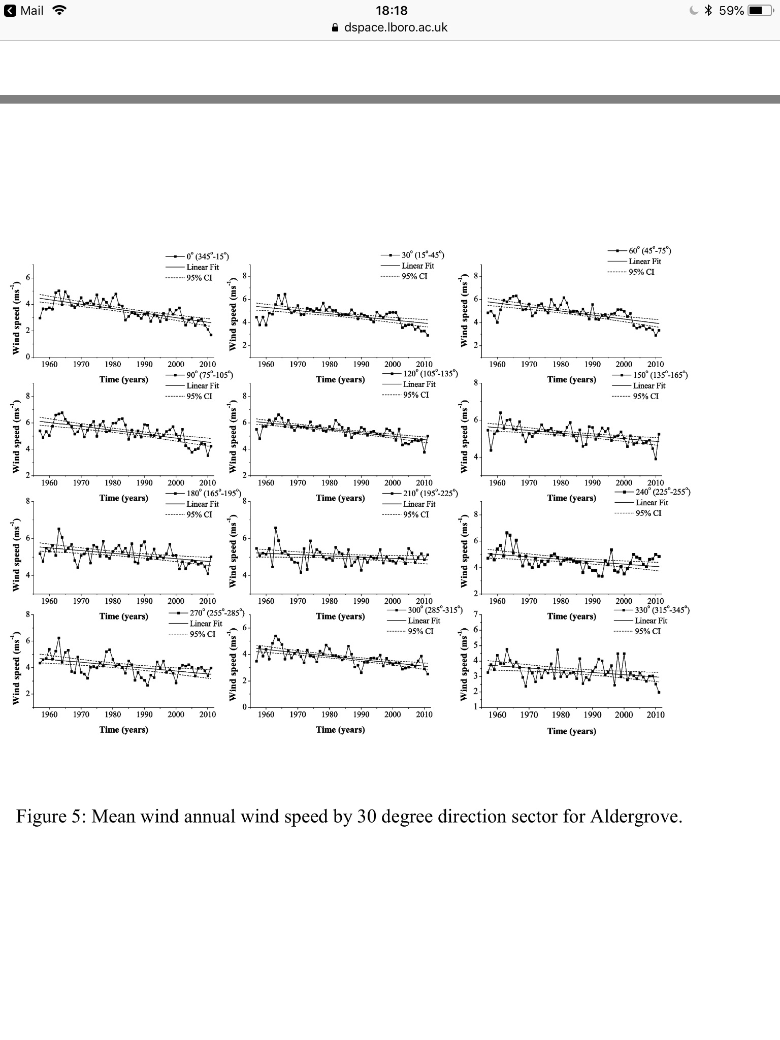

Post Options Post Options   Quote Guests Quote  Post ReplyReply Direct Link To This Post Posted: 03 Apr 21 at 9:57am
The best I can find on wind speed trends are the following - if anything there has been a drop on average wind from 70’s till recently, but don’t have the last few years data.
