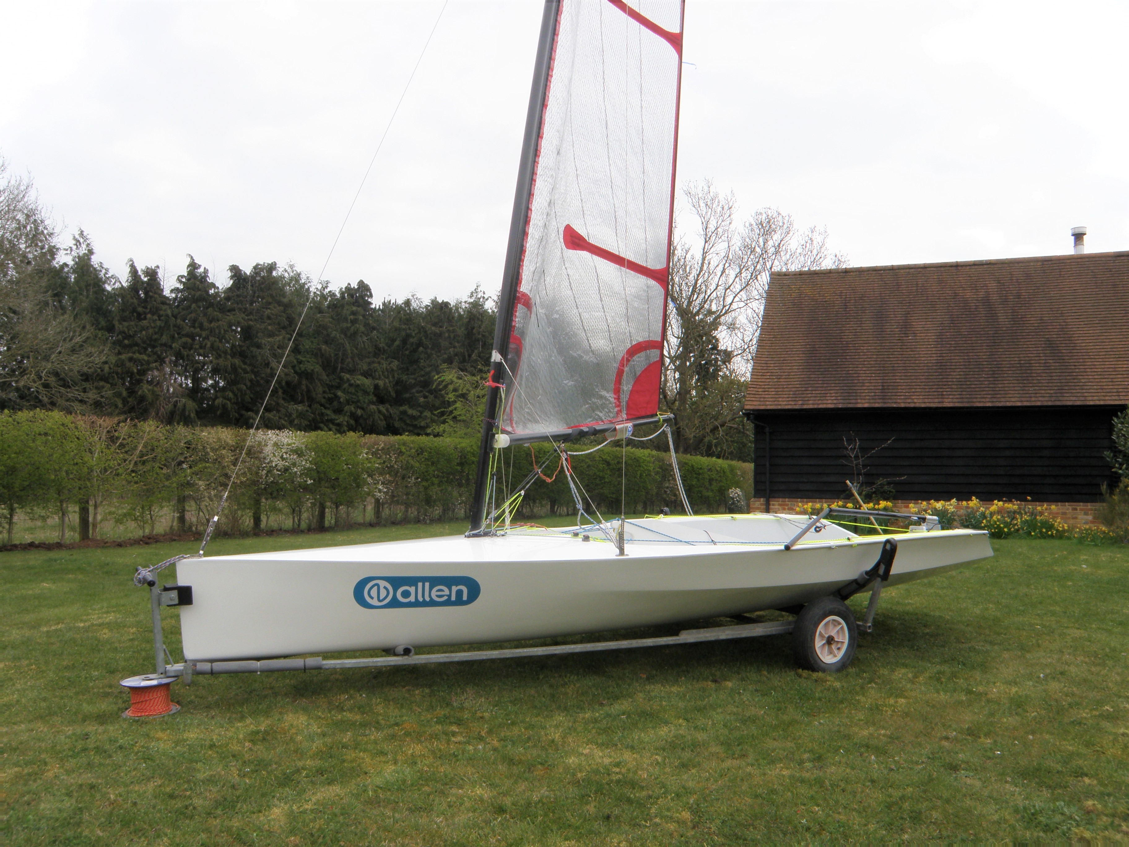

Well done Cirrus and GRF for actually doing some development!  I like the look of both :)
The toe straps look a long way away?

..... and (if) I was willing to be on my knees downwind then it looks great ...
One of the ideas considered but not tried on this 'Hybrid' was to recognise that many don't use decent knee pads.  So if ever a production version was on the cards, in some distant future, I would look at having the floor with sectioned recesses to inset  high(ish) density foam.  The areas would need to be fairly large - but at this stage it is simply not necessary and would be an extra complication.  Would be nice to be able to wear a shortie wetsuit in Summer and no knee pads ? Yes I know !

One of the advantages of the Solo is that the inside of the tanks are sufficiently close to the centreline that you can still perch on them while sailing downwind ... probably won’t work in this case but worth a thought.
Quite a sweet looking boat, would be in there with the Hadron if I was considering Handicap racing every weekend.

Off the boom sheeting?
What about something like a spoiler across the back, perch on there when running?

If I'd seen this yesterday before 12 I would have posted you need to add a kite to it....
It's a lovely hull form Mike, hope you have fun with it at some point soon.

Its a nice looking, and clean layout of a boat.
Not sure about the yellow take-up lines running down the side decks. Arnt you gonna be sitting on them and wont that be uncomfortable?
Also, it looks, as already suggested, the toes straps are too inboard.
Looks good though :-)

Not sure about the yellow take-up lines running down the side decks. Arnt you gonna be sitting on them and wont that be uncomfortable?  Also, it looks, as already suggested, the toes straps are too inboard....
All easily changed ... but it suits (me) for now.  Regarding comfort I wear hikers anyway and yellow shock-cord is what I've got available here.  Just wanted the most simple fly-aways for now.  The prime point of 'Hybrid' is/was to see what works in terms of the hull form and rig(s).   The hull is very easily driven but not too 'tricky' at all  and this general form and rocker in other boats has proven very very slippery.  It also 'should' be good for 'heavies' but we would really have to establish the effective crew weight ranges on the water.  The spars could carry less sail area or go all the way up to about 11.5m (but I do not think that would be needed at the moment).  Toestraps - easy to change, modify, alter to suit crew sizes and preffered sailing style - and not something I'd ever propose restricting.  I've not mentioned hull weight yet .. it is lightish and is between 55-60kg with centreboard in place.  If it goes much further then 45-50kg would/could be the target in epoxy.  You could go lower of course but I'd be then start to get concerned about practicality /durability etc..
