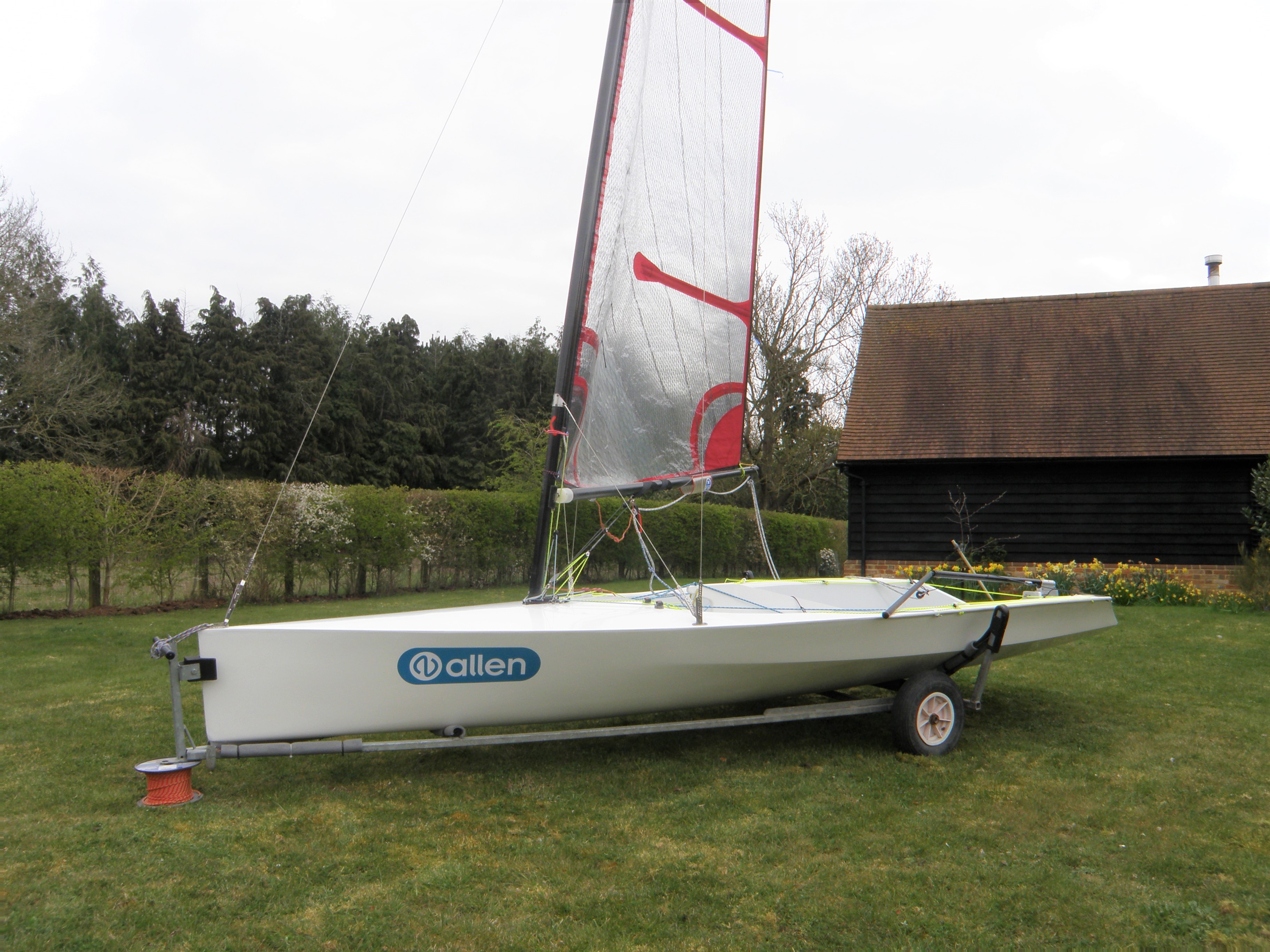

Bimbling with boats is about all many of us can do for the foreseeable ...  So here is one I started cobbling together over the winter.  Just 'finished' this 'special' with the current limitations allowing a fast finish but cannot test / trial yet of course !!
It is simply called 'Hybrid' for now and is 4.25m overall and maximum beam of 1.60m (and lightish).   A mixture of ideas in fact to trial / assess.  Initial sail area in photos is approx 9.3m2 and the spars used here are carbon.  Intended primarily as a non-winged hiking design with centreboard with a higher boom could also make a GRF style trapeze platform maybe.  Why do it ?   But equally and especially now ...Why Not !
Posted By: Noah
Date Posted: 01 Apr 20 at 1:26pm
Is that a Blaze rig on an Icon hull? I thought the gunwhale lines were straighter on Icon than in these pics?

Posted By: Cirrus
Date Posted: 01 Apr 20 at 3:13pm
Not a Blaze rig ... though the mast is v.similar to both Icon and the Blaze 'family'.  Not H2 in terms of general ‘bulk’ or freeboard but with a bit more (v.necessary imo) than say a Zero.    The original concept was for an exceptionally easily driven simple hiking hull but not to the point of becoming ‘demanding’ light and simple but capable of carrying a reasonable weight.  The hull underwater is almost pure Icon, (cos that one really is slippery yet ‘easy’) but it is 215mm (9") shorter and the freeboard is very much less than found on an Icon or H2.  The sail in the pics is in fact based on an early Icon development main but modified by Dick Batt to suit the rig dimensions and rake.  (The boom is currently made from old Blaze outer wing tubes – cos I was waiting too long for a larger diameter tube to arrive)   So NS14 inspired with touches of Blaze, Icon. and yes even some  H2 and Zero in there if you like !    This concept is much lighter than say a Blaze and if ever in full epoxy would be much lighter still.
Posted By: iGRF
Date Posted: 01 Apr 20 at 3:14pm
Originally posted by Cirrus
.  Why do it ?
Because there is a gaping great hole where a sensible trapeze single hander should be, so we don't have to continue with the absurd notion that 15 grand gets you over 100 kilos to lug about...
And why can't there be a boat where you make a choice of trapeze or racks, they both pretty much do the same thing, except one looks much cooler and doesn't bugger your knees.
Then we won't have to bugger about ordering new sails to make our Farr 37s go early enough to cope with the Laserati off the start line..
Posted By: H2
Date Posted: 01 Apr 20 at 3:57pm
H2 and a D0 had a child. I like it!
However, if I wanted a boat that was really nice to hike I would keep my H2 but if I wanted a boat that was more like a D0 but that carried more weight and I was willing to be on my knees downwind then it looks great.
Only question would be whether the rig was big enough? Most of the boats that aim at the bigger guys continue to feel a little under powered in my view, but that is a minor point!

Posted By: Cirrus
Date Posted: 02 Apr 20 at 8:50am
..... and (if) I was willing to be on my knees downwind then it looks great ...
One of the ideas considered but not tried on this 'Hybrid' was to recognise that many don't use decent knee pads.  So if ever a production version was on the cards, in some distant future, I would look at having the floor with sectioned recesses to inset  high(ish) density foam.  The areas would need to be fairly large - but at this stage it is simply not necessary and would be an extra complication.  Would be nice to be able to wear a shortie wetsuit in Summer and no knee pads ? Yes I know !
PN ?  Not of interest any more – given previous experience with that rat’s nest ...best I don’t comment too much.  I’m maybe not as conspiracy suspicious as say GRF but some of the ‘experimental’ numbers produced way back could have done with some ‘full workings shown’ to increase confidence at the time.    Far far too early to do more than speculate anyway ....

Posted By: ttc546
Date Posted: 02 Apr 20 at 11:03am
Its a nice looking, and clean layout of a boat.
Not sure about the yellow take-up lines running down the side decks. Arnt you gonna be sitting on them and wont that be uncomfortable?
Also, it looks, as already suggested, the toes straps are too inboard.
Looks good though :-)
Posted By: Cirrus
Date Posted: 02 Apr 20 at 4:08pm
Not sure about the yellow take-up lines running down the side decks. Arnt you gonna be sitting on them and wont that be uncomfortable?  Also, it looks, as already suggested, the toes straps are too inboard....
All easily changed ... but it suits (me) for now.  Regarding comfort I wear hikers anyway and yellow shock-cord is what I've got available here.  Just wanted the most simple fly-aways for now.  The prime point of 'Hybrid' is/was to see what works in terms of the hull form and rig(s).   The hull is very easily driven but not too 'tricky' at all  and this general form and rocker in other boats has proven very very slippery.  It also 'should' be good for 'heavies' but we would really have to establish the effective crew weight ranges on the water.  The spars could carry less sail area or go all the way up to about 11.5m (but I do not think that would be needed at the moment).  Toestraps - easy to change, modify, alter to suit crew sizes and preffered sailing style - and not something I'd ever propose restricting.  I've not mentioned hull weight yet .. it is lightish and is between 55-60kg with centreboard in place.  If it goes much further then 45-50kg would/could be the target in epoxy.  You could go lower of course but I'd be then start to get concerned about practicality /durability etc..
Maybe the forumites and 'powers that be amongst them' could run a 'specials' meeting (when circumstances permit of course) for a few or many of us to try out new ideas and 'odd craft' thrown together during this odd time in history.  Building / modifying craft without rules for a change is good fun occasionally and quite liberating as wel as educational.  It could get the minds of the many working on 'Hybrids' instead of thinking all the time about the bl**dy virus !!

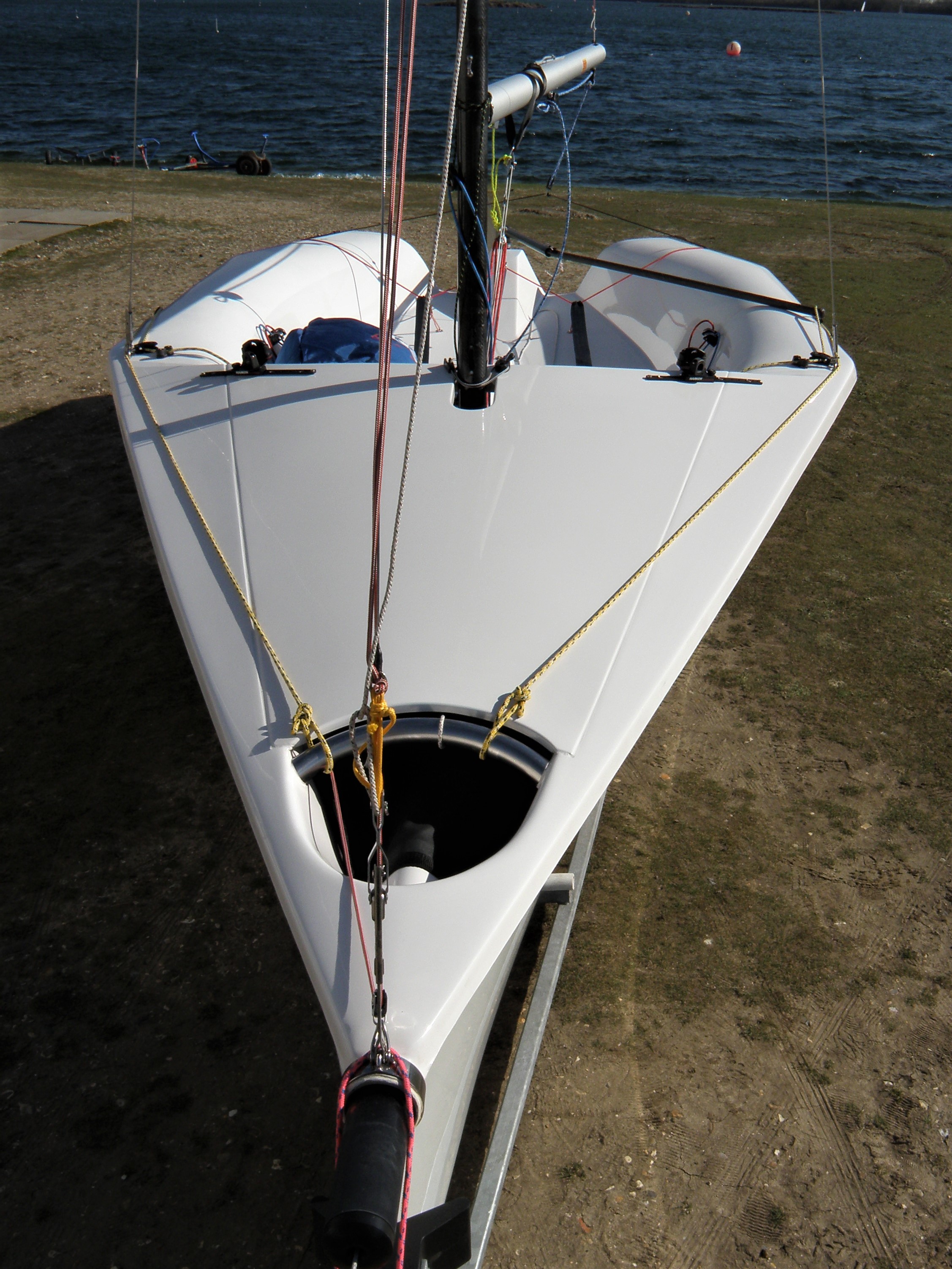

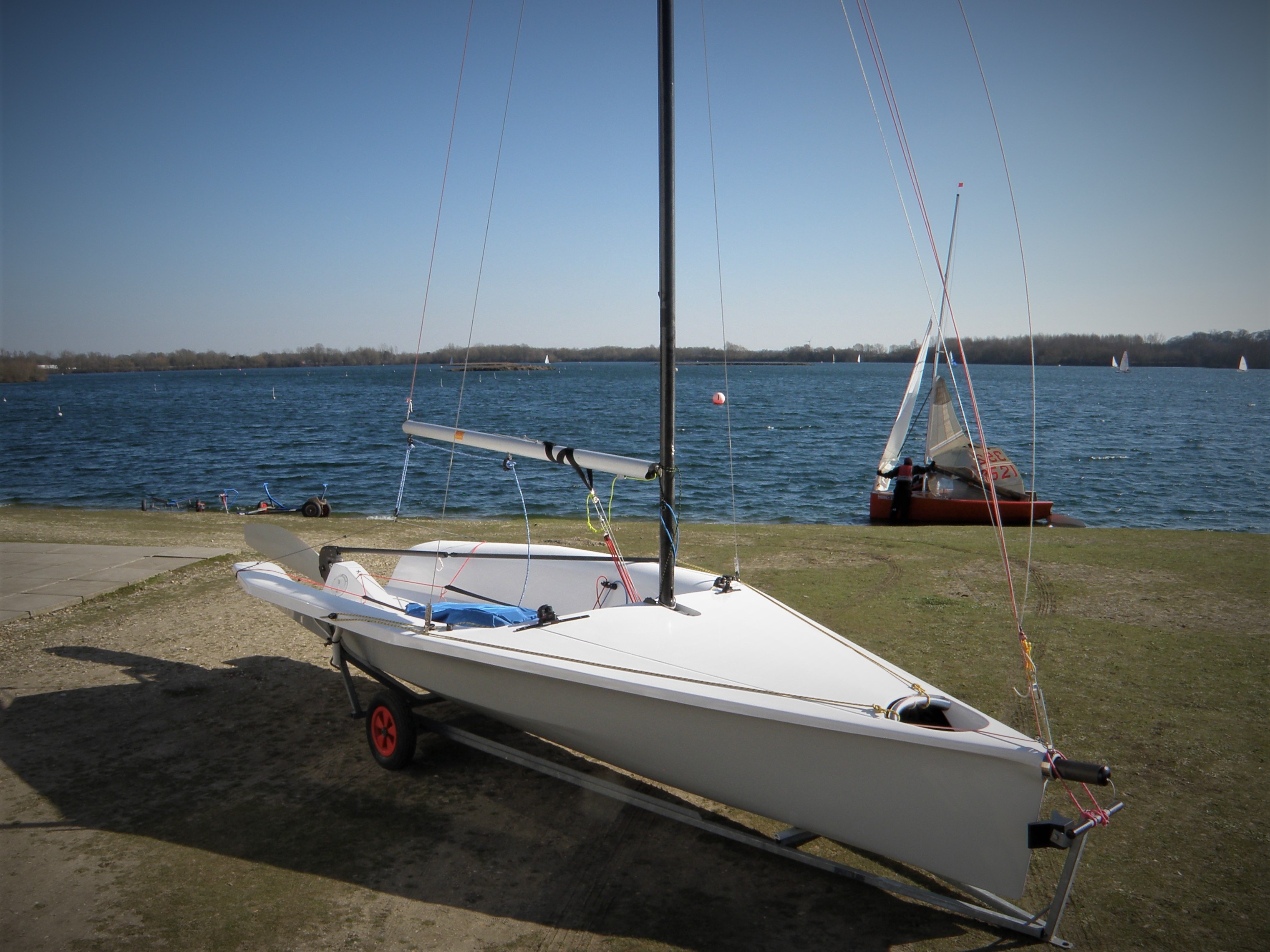

Date Posted: 10 Apr 20 at 8:16am
Another teaser for you .....  Well you have got to try stuff !

Posted By: iGRF
Date Posted: 10 Apr 20 at 10:14am
Put the forestay behind the kite chute. Seems an obvious solution that most dinghy designers fail to spot.

Posted By: Cirrus
Date Posted: 10 Apr 20 at 4:03pm
Forestay behind chute ?
No a conscious design choice - with any very fine bow you can end up with a small and awkward shaped chute if you place the forestay behind.... or the forestay ends up a mile back along the foredeck.  We made a deliberate choice to have a relatively generous and low friction chute arrangement relative to other designs behind the forestay.  The clew on the asymetric is cut high on this craft to really aid crew sight lines offwind and this feature plus the very generous chute proportions make raising/dropping a doddle.  Much of the problem found with some designs has a lot to do with trying to get a large sail area and lowish clewed spinnaker into/out of a (relatively tight and under-sized) chute - regardless of where located....

Is that the Rondar Icon derivative intended for the US market?  Is there any news on that front?  Looks good by the way!
Date Posted: 10 Apr 20 at 5:22pm
It was a very common config in the early days of kite chutes, and you'll see it on a few classes still. Merlins for example. There are significant disadvantages though, which is why most classes have changed to having it further aft.
Posted By: 423zero
Date Posted: 10 Apr 20 at 5:28pm
Switching tacks? Presumably it would foul forestay.

Posted By: iGRF
Date Posted: 10 Apr 20 at 6:55pm
Significant disadvantages? Maybe on symmetrics where you need to recover the kite after the pole, not that I've got much of a clue about that ancient world, but Assyms? Can't see any, quite the opposite in fact, the kite needs to be close to the pole as it retracts. I have though often postulated about an alternative hybrid system between assym and sym using maybe a dangly pole so a system could be contrived to use round cans on lakes for a single hander, not fully thought it right through yet but I'm sure there must be a way.

Posted By: ttc546
Date Posted: 11 Apr 20 at 9:55am
Any reason you didnt keep the gnav for the current iteration?
Posted By: Cirrus
Date Posted: 11 Apr 20 at 10:15am
The boat is a test bed... Advantages both ways as ever but nothing 'works' quite trying out all options and then making a decision.  It is too easy to rush to market having made assumptions on what is 'best'... time spend checking is no luxury.

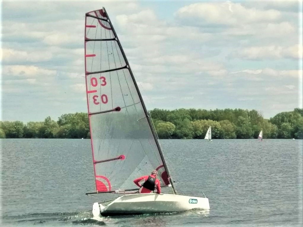

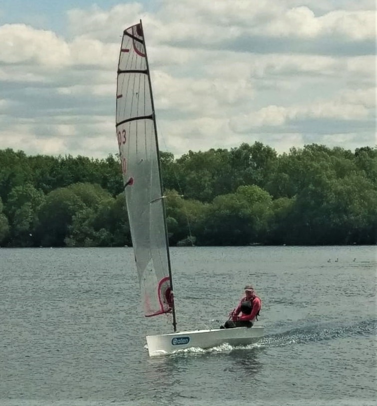

Date Posted: 17 May 20 at 10:54am
On the water at last for the first time this weekend.  A gentle start chasing a couple of Blazes around Burghfield in the sun ... at a 'distance respecting' basis of course for about 90 minutes.  Brilliant to be out there in anything really after the last couple of months.   The basic balance and handling is pretty much spot-on and it goes rather well both up and downwind with very good pointing angles with upwind pace already.   No vices to report in a breeze that was not ever more than 12mph but a bit of bimbling to do with toestraps perhaps inevitable and other tweaks will be needed I'm sure.  The sitting out area of the deck is not great yet but that was fully expected - will need to use some decent hiking shorts next week but longer term this area was to be modified anyway.  But at least now it looks like that additional effort is worth undertaking !.
Posted By: Neptune
Date Posted: 17 May 20 at 12:03pm
It looked like a good start for the few minutes I watched. A powerful looking boat that’s going to take some strong hiking to get the potential from it so that deck shape and toe strap positions will be critical.

Posted By: Cirrus
Date Posted: 17 May 20 at 3:23pm
Posted By: tink
Date Posted: 17 May 20 at 3:44pm
Was ‘alert’ and out on the water as this was being tested, very pretty boat and from where I was looked quick.
Tink
https://tinkboats.com
http://proasail.blogspot.com
Date Posted: 17 May 20 at 6:12pm
Looks big - what weight are you expecting it to work well with?
Posted By: Cirrus
Date Posted: 17 May 20 at 6:29pm
It is not that big really .... 4.25m overall with beam of 1.58m.  (so approx 14' long) The development sail in the photos is approx 9.4m but the hull is very easily driven.  Itt should be a reasonable weight carrier (..a wide range was planned for anyway) but this will be driven by sail area, which can be varied of course, as much as anything.   It is a lowish rocker one.   I'm just over 80kg myself but the hull is not that extreme and I would guess it should be good (ie still 'working' well) up to 95+kg with this area of sail.  We have other sails to try in due course including 8.8m and 10.4m

Posted By: Cirrus
Date Posted: 22 May 20 at 9:46am
Spent another couple of hours late Wednesday afternoon with 'Hybrid'.  All it really needed for comfort was an adjustment of toestraps (now nice and cosy) plus wearing some decent hikers.  We will make changes to the sit-out side deck positon in time but with hikers now it is well down the near future revise 'list'.  Immediate things to try is 1) a tad more rake of the rig plus 1) a switch to a slightly smaller centreboard.  Previous two sessions proved the boat pointed very high as hoped while still keeping pace on but a tad more rake may prove even more effective still.  Need to quickly establish those limits.  Any reduction in drag and weight with a smaller board cannot but help if the overall area really can be reduced - but there is nothing like actually sailing stuff  to prove anything - The original board used in the first two outings was similar but is approx 15% larger in area though the same length overall.
The focus now in summary is to optimise upwind performance as far as reasonably possible before anything else... generally speaking if you get that right initially the rest usually follows....  The sparring partner on Wednesday was interestingly an Icon so an excellent challenge with known and capable up-hill pointing characteristics - longer hull of course though broadly similar under water so it was interesting to see the relative strengths of the two boats.  Breeze was again relatively light and not ever much more than 10 mph - ideal at this stage.  So the few tweaks to sort later today (Friday) and another planned on-water session on Sunday with a slightly higher wind forecast at this point of 13-14mph.  In some ways undertaking this sort of work  without the distraction of formal class racing being available in established classes is good... you can focus on the task at hand and others seem very willing to act as distanced sparring partners .. as they keep a watchful eye on the 'strange new craft'.... Wink

Posted By: Cirrus
Date Posted: 25 May 20 at 10:08am
Adjustments to the mast/deck step and a bit more rake seems to work ... plus a bit more slack in the lowers.  This appears to allow the mast to 'work' a bit more upwind.  Sunday was a slight step up in wind strength on the previous sessions and some full-on hiking with a bit of depower was needed on occasion.   The alternative (slightly smaller) centre-board still fully maintained the  upwind performance but things just felt a bit 'better' - difficult to define really but it is about the general 'feel' of a boat.    Still have not tried the other available sails (different areas available) but the justification is to keep that aspect constant for a while yet and keep trying out different rig. settings.   This time the 'stalking horses' included the regular Blazes plus a solitary Aero.  In the full breeze occasionally available the Blazes looked very comfortable - as expected given the wing leverage but 'Hybrid' did not lose out too much.  Offwind they are fairly equal in terms of performance - especially pleasing given the smaller sail area of Hybrid.  Below wind of 10 mph or in lulls Hybrid had an edge and held the Blazes or crept away upwind for more of the time This was also fairly obvious running deep offwind .... But the hull is particularly easily driven and might equally work pretty well with the smaller sail as well- so might try that before too long.  The Aero was limited by the 7m sail used but went well in the gusts.    Next session is planned is Thursday /Friday.
