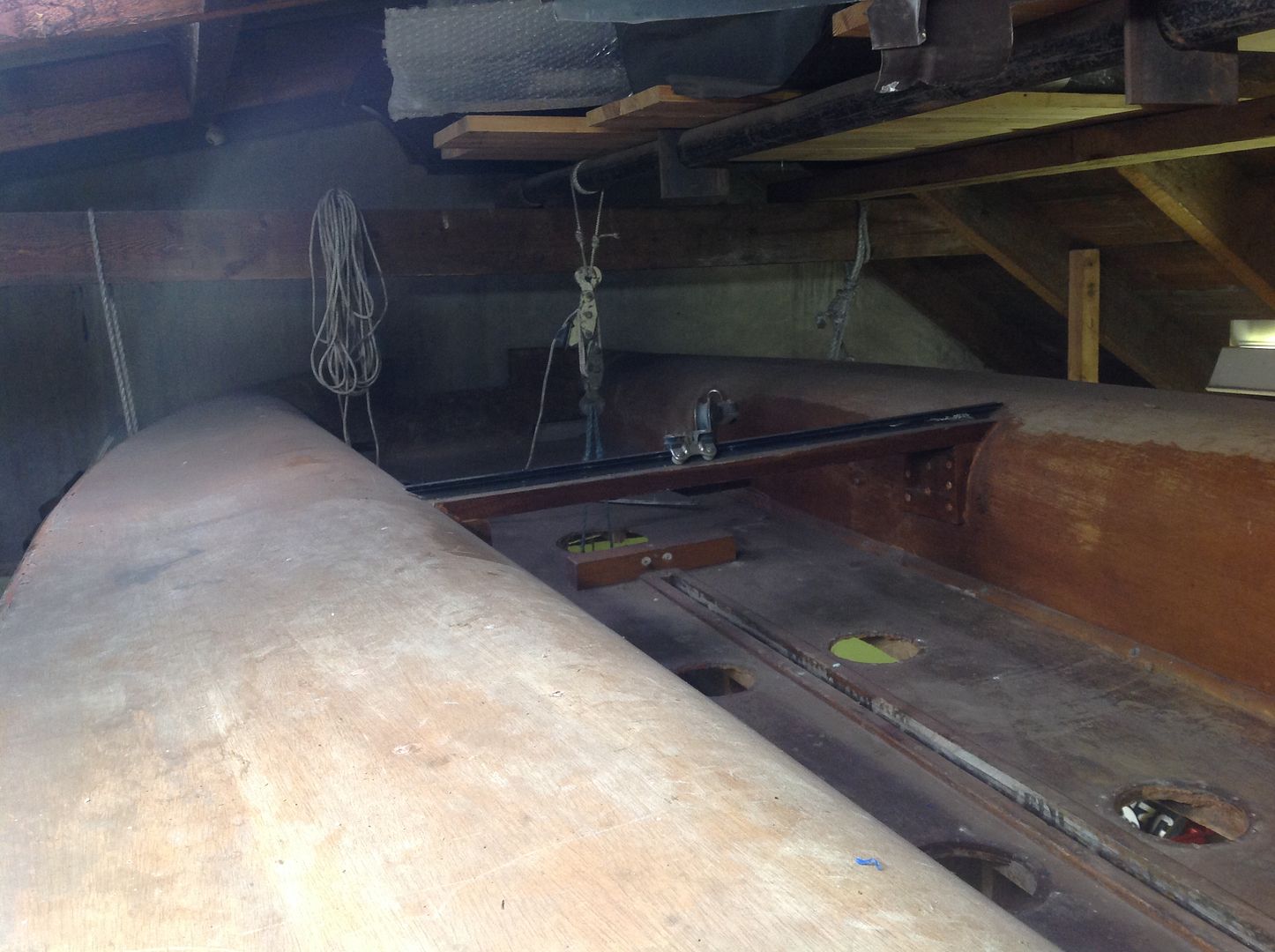

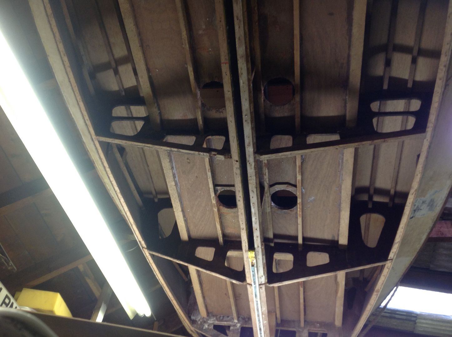

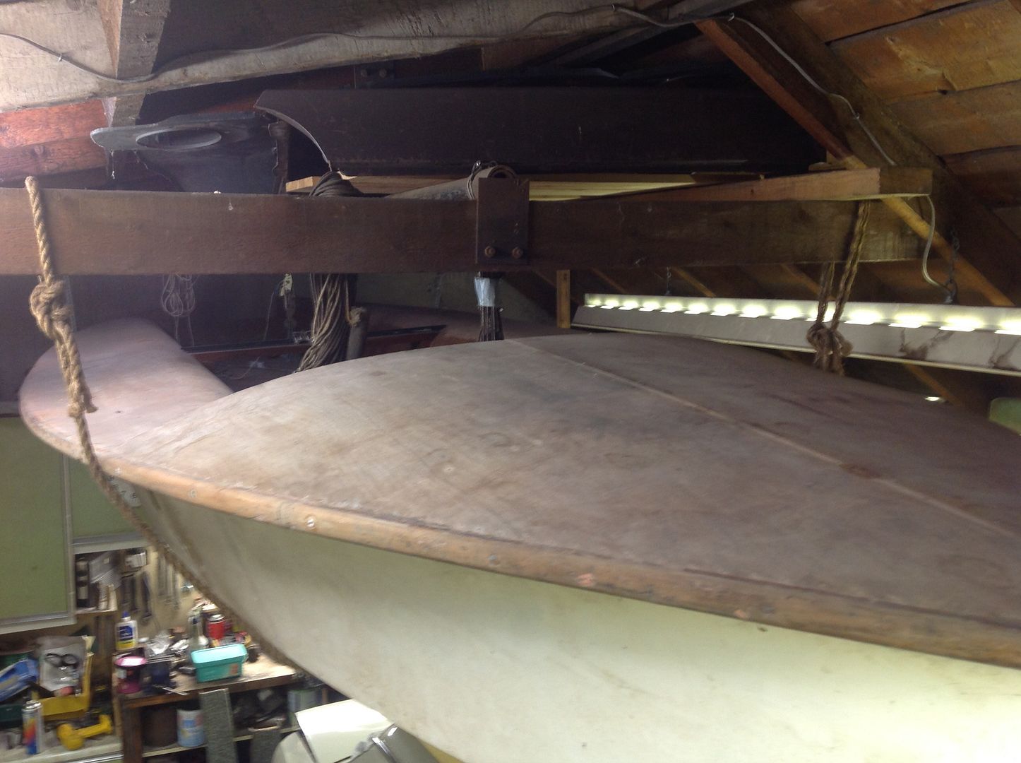

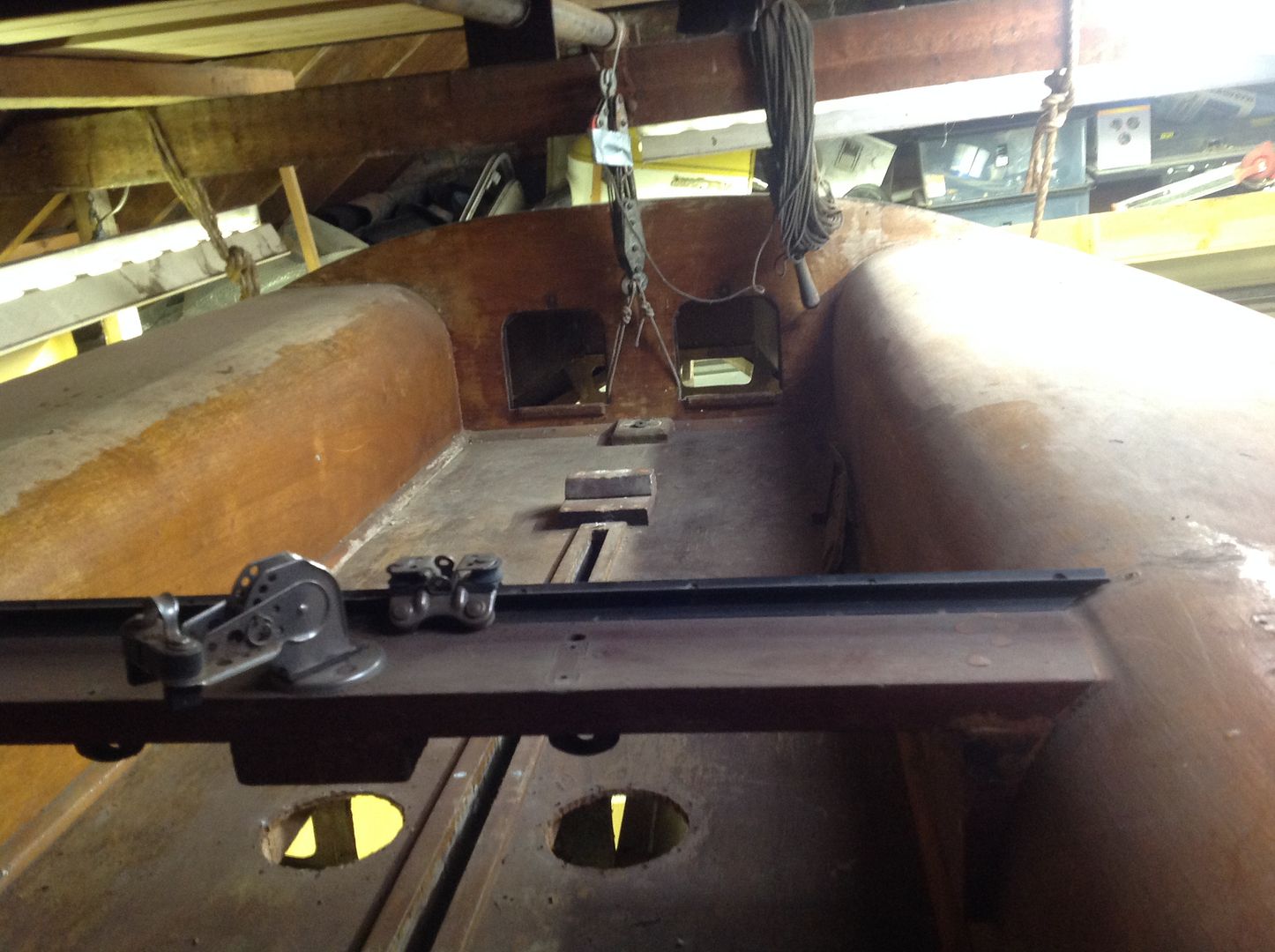

Took some more pics today,
I started to strip the varnish off 35 yrs+ ago !!! The wood on the top sides are really in good condition, so a bit more stripping and sanding should do it. Since the boat has been dry stored for so long, will the wood inside be needing some kind of treatment . Before the bottom is glued and screwed on ? The inside is in a good state too, but bare wood. So any help would be much appreciated how to get this Daring back on the water. I think it has some really sweet curves on it. Thanks Tor
Conventionally I would have thought the insides should be varnished or painted. I tend to slap on several costs of heavily thinned down cheap varnish with a large brush: after all UV resistance is hardly a problem! Wood self draining boats are sods for rot because its so hard to keep the humidity down, so it does need doing.
Maybe some worm/rot killer first? What does the panel think? Edited by JimC - 13 Jul 15 at 10:17pm |
boatshed ![]() Far too distracted from work ![]() Joined: 12 Apr 05 Online Status: Offline Posts: 457 |
Sounds a good start. I too would be in favour of thinned down varnish that soaks in to the wood. How about thinned epoxy instead? Is that available? I'm surprised to see the boat is self draining but it looks like it was built that way; or heavily modified. Was the original design self draining? As Jim says, water will get trapped especially around the frame joints to the bottom hull wood. I see there are a number of hatches which will help with air circulation, so, maybe with these kept open and a very good cover, you would be in with a chance. I doubt worm killer will be needed. If the wood is dry it is very unlikely to have living worms. Have you got the mast, boom, centre board and rudder? Personally, I would ditch the sliding seat and put a trapeze on for the crew. Good luck. |
Steve
chrisg ![]() Really should get out more ![]() ![]() Joined: 23 Mar 07 Location: United Kingdom Online Status: Offline Posts: 893 |
I think West do a thin epoxy that you paint on the dry wood which will help with moisture resistance. From what I remember its ok under varnish too so just coat the whole boat in that (inside tanks before you stick the bottom on would be a great help).
