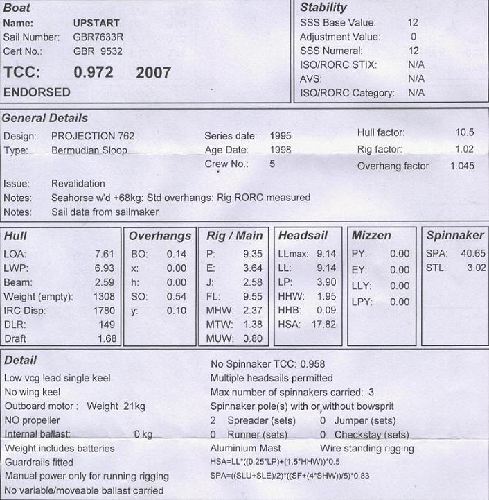

Having just had a re-read of this thread I find Upstart seems to rate higher than a lot of other projections despite having a small kite and spin pole. Have attached a section from my certificate, could anybody identify where I'm getting penalised? Edited by TimC |

with a rating of .979 my projection is surely the most harshly rated! i have full size main, 150% genoa, 50.88m kite and 3.25mt pole. weight is 1300kg. spinnaker area is pretty cheap under irc so i'd say your higher rating comes from relatively light weight and max size genoa. i agree with the concensus that she likes a good breeze and seems to be a quick upwind boat. upwind flat water im aiming for 6.0 knots with lots of height easing for 6.2-4 when a chop presents itself and thats in about 10knots true. i'd really like iif nigel theadom could give us a few tips on rig set up!
That's a pretty tough rating but you do have +10sqm on your kite compared to me with weights about the same. Nigel Theadom owns the rig shop at the marina I'm berthed in and has been massively helpful with tips and other advice. He sorted out my chainplates and set my rig up. So all I have to do is sail the thing properly! |

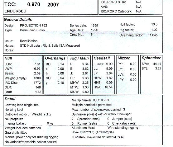

TimC, Here's mine, 1.3 sqm less headsail, 4 sqm more kite, longer pole. Just goes to show what they say, Spin area is cheap under IRc. Once again I am thinking, a 762 with a 100% light, full jib and a 60sqm masthead kite (and a beefed up topmast!) now what would that be like? Btw, trounced by the J80s again this weekend, in lightish airs. My Genoa is knackered, anybody got a good one going spare? otherwise, I might have to spend some proper money Kev. Zulu |
That's very interesting - the smaller genoa more than offsetting the larger kite. Weights seem interesting too. I notice you have std hull data at 1300. Upstart was 1240 when weighed and has 68kg added to the keel so is 1308 now in total. Other boats seem to weigh a good bit more than this - so I've clearly got a very light one. Edited by TimC |
