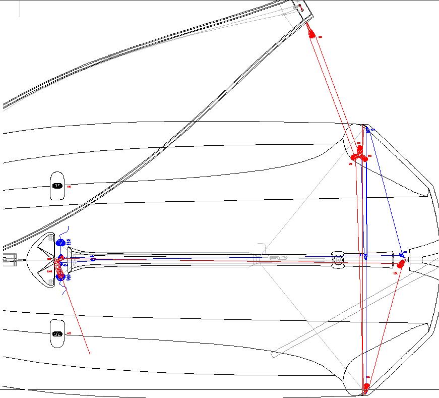

Oh yeah, as for the mainsheet / traveller. I obsessed for a long time about how to get an adjustable sheeting range to 15deg with aft boom takeoff (as necessitated by the wishbone), whilst retaining the better ergonomics of the centre main, and without the cost/complication/sand clogging/toe banging possibility of a traveller track.
After much effort I hit on an idea that I have been pointed out is similar in many ways to a self tacking jib system - the traveller "car" can move on the traveller bridle independantly of mainsheet tension. I get  a 2:1 from deadended at the transom corner (P), up through the "car", to the boom, back through the "car," down to transom corner (S) where it is led down under a ridge on the centre of the cockpit floor (avoiding tiller interference), and led back to an upside down main ratchet block in the middle of the cockpit, also avoiding inetrference from a split bridle on the front end of the toestrap, which, like most of the cockpit attachments, is made by simple lashings onto moulded in flush surfboard leashplug inserts. The traveller too is led back under the cockpit to split controls in the middle of the cockpit.
The bridle itself can be kept bar tight withought ever interfering with the tiller (which has a fairly old school curve to it, which exists to just avoid hitting the side of the cockpit).
All a bit novel/risky and I consider myself pretty lucky that all of it seems to work ok. So far.
Traveller controls in blue, main in red:
Lukepiewalker View Drop Down
Joined: 24 May 06
Posts: 1341
Post Options Post Options   Quote Lukepiewalker Quote  Post ReplyReply Direct Link To This Post Posted: 18 Nov 08 at 5:20pm
That's what I figured from looking at it for a while. Nice, elegant, complicated yet simple.. string...

Post Options Post Options   Quote HannahJ Quote  Post ReplyReply Direct Link To This Post Posted: 18 Nov 08 at 6:45pm
Does the red three-blobbed thing (I assume the "car"?) move across like a traveller, or is it fixed? similar to a mirror style then.
MIRROR 64799 "Dolphin"
Daniel Holman View Drop Down
Joined: 17 Nov 08
Posts: 997
Post Options Post Options   Quote Daniel Holman Quote  Post ReplyReply Direct Link To This Post Posted: 18 Nov 08 at 7:10pm
Indeed the red 3 blobbed thing can indeed move across the traveller independantly of the mainsheet tension. And is controlled by the blue single blobbed thing also known as the traveller. There is a pic that makes it a bit clearer a couple of pages back. Its not much like my old mirror at any rate.
HannahJ View Drop Down
Joined: 23 Jul 05
Posts: 861
Post Options Post Options   Quote HannahJ Quote  Post ReplyReply Direct Link To This Post Posted: 18 Nov 08 at 8:56pm
No, I thought it was fixed at the corner, not at all like a mirror at all. I was referring to the triangle you get with the mainsheet coming from one corner.  Very original mainsheet system!

radixon View Drop Down
Joined: 27 Oct 06
Posts: 2407
Post Options Post Options   Quote radixon Quote  Post ReplyReply Direct Link To This Post Posted: 18 Nov 08 at 9:53pm
To save HannahJ the embarement and  I'll repost the picture showing the traveller system in the flesh
