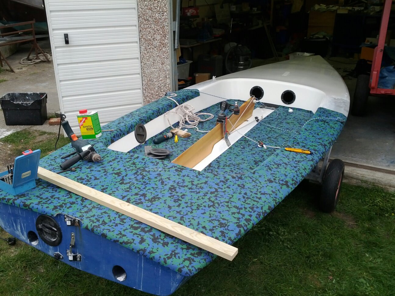

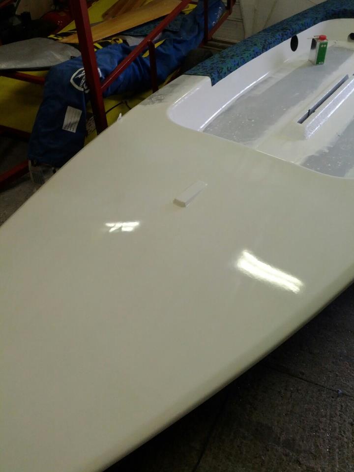

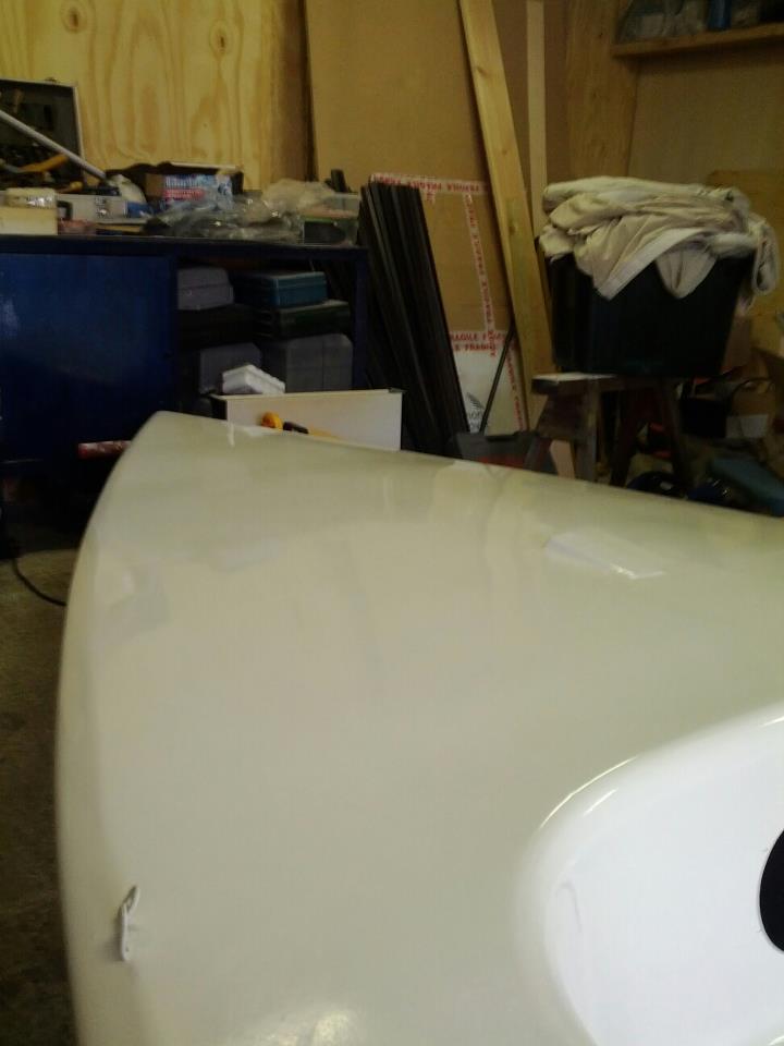

Some pictures of the contender during its winter work.
She is almost there. We have removed nearly 3Kg of gelcoat from the top deck alone, sanded all of the old embossed grip off, removed 1.5 Kg from lead I found in the hull.
Another coat of paint and a little more grip and itll be there.
New mast step going on as well as a few new blocks.
Picking up the carbon mast next weekend, she'll be race ready for next thursday.
Dan

Do you need to get contenders reweighed when you take out the lead?
hollandsd View Drop Down
Joined: 12 Oct 06
Posts: 853
Post Options Post Options   Quote hollandsd Quote  Post ReplyReply Direct Link To This Post Posted: 08 Apr 12 at 8:59am
Anything that affects the mass of the boat means it will need to be re-measured and recorded.
I have kept the lead that i have removed just incase she is underweight. She was overweight before i started to do the work

Post Options Post Options   Quote Ruscoe Quote  Post ReplyReply Direct Link To This Post Posted: 08 Apr 12 at 10:07am
does that involve a full re-measure in the contender class or just a re-weigh and stamp on the certificate?
winging it View Drop Down
Joined: 22 Mar 07
Posts: 3958
Post Options Post Options   Quote winging it Quote  Post ReplyReply Direct Link To This Post Posted: 08 Apr 12 at 6:14pm
I think it's just a re weigh of the hull, then the cert signed.  Looks great!
Edited by winging it - 08 Apr 12 at 6:14pm
Post Options Post Options   Quote Rupert Quote  Post ReplyReply Direct Link To This Post Posted: 08 Apr 12 at 6:38pm
With that much pro-grip, you may not need the lead!
Looks good, should be fun.

Post Options Post Options   Quote allanorton Quote  Post ReplyReply Direct Link To This Post Posted: 08 Apr 12 at 7:36pm
That progrip will make it much nicer to sail, the added weight will make little difference. Thumbs Up

Post Options Post Options   Quote Neptune Quote  Post ReplyReply Direct Link To This Post Posted: 08 Apr 12 at 8:13pm
How do you take gel coat off neatly then reapply?
Musto Skiff and Solo sailor
Joined: 12 Oct 06
Posts: 853
Post Options Post Options   Quote hollandsd Quote  Post ReplyReply Direct Link To This Post Posted: 08 Apr 12 at 8:16pm
I have spent hours sanding and filling then more sanding. I have applied a painted finish instead of gelcoat as its a fraction of the weight.
