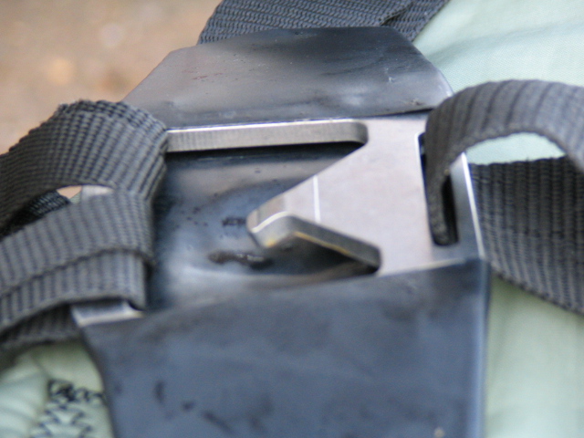

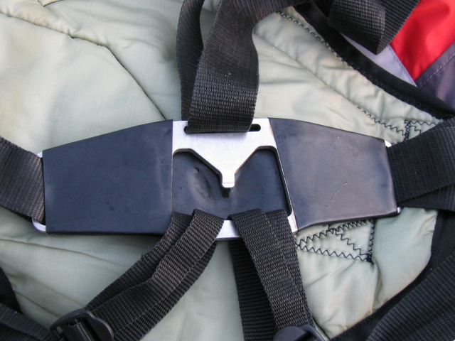

I've been pinned onto a gunwale lip by a trapeze hook on a boat that flipped again as I was trying to roll into the boat, that was touch and go for what felt like an age, and a club-mate had a very close call when he got hooked to a shroud of a 5000 which then inverted.
I also had the deck and hull punctured on my Winder Fireball by different trapeze hooks. So I'd say there is certainly a need for something better. Interesting to see that Allen have openly adopted the Bethwaite idea, which we discussed some time ago. I don't recall seeing the "solid aluminium handle" before. Bet that could catch you a nasty smack in the eye - even plastic bobbles on adjusters can hurt. The problem, of course, is that you'd need a second harness if ever you wanted to scratch crew another boat with the usual rings. Personally I'll stick with the flush hook solution. It works with normal rings, my crew is happy with it, and a number of club-mates have adopted it too. |
Yes MM those flush plates have been on the edge of my radar for some time. Very interested to hear that you like them. I do think I will give one a try. Can you spill on who stocks them?
The inventor/maker sadly died last year, but a club-mate at Wilsonian plans to have a small production run made, so there should be a stock available shortly. I'll suggest he comes on here so that people can p.m. him.
