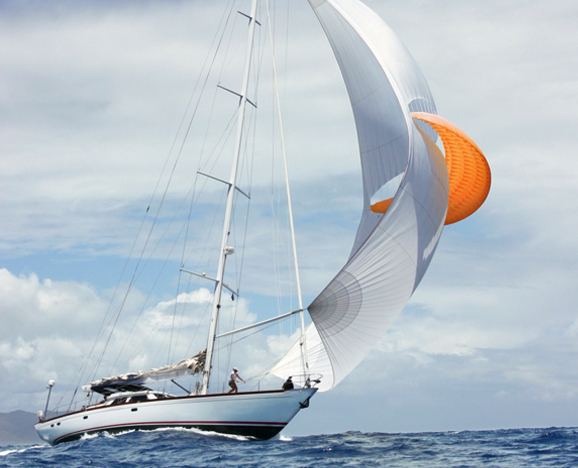

Interesting stuff...

Looks like a cunning means of adding a slat effect into the kite?  Slats in foils greatly increase lift, so should add performance.  Not sure how strong/reliable or easy to trim it would be though?
