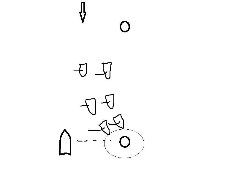

Was previously the downwind 'leeward' mark so was a straight downwind finish.

Even if the mark is one end of a start/finish?? you sure about that??
Why not? Rule 18. Mark room.

You're not obliged to give room at the start.. are you at the finish? |
Yes |
Bandin, were the boats running, reaching or beating?

They were heading straight downwind to the finish |

Did it look something like that?
Section C rules do not apply at a starting mark surrounded by
navigable water or at its anchor line from the time boats are
approaching them to start until they have passed them. No mention what so ever of it not applying at a finish, any big fleet race has tons of people screaming for room at the finish

That's exactly the scenario Thank you
