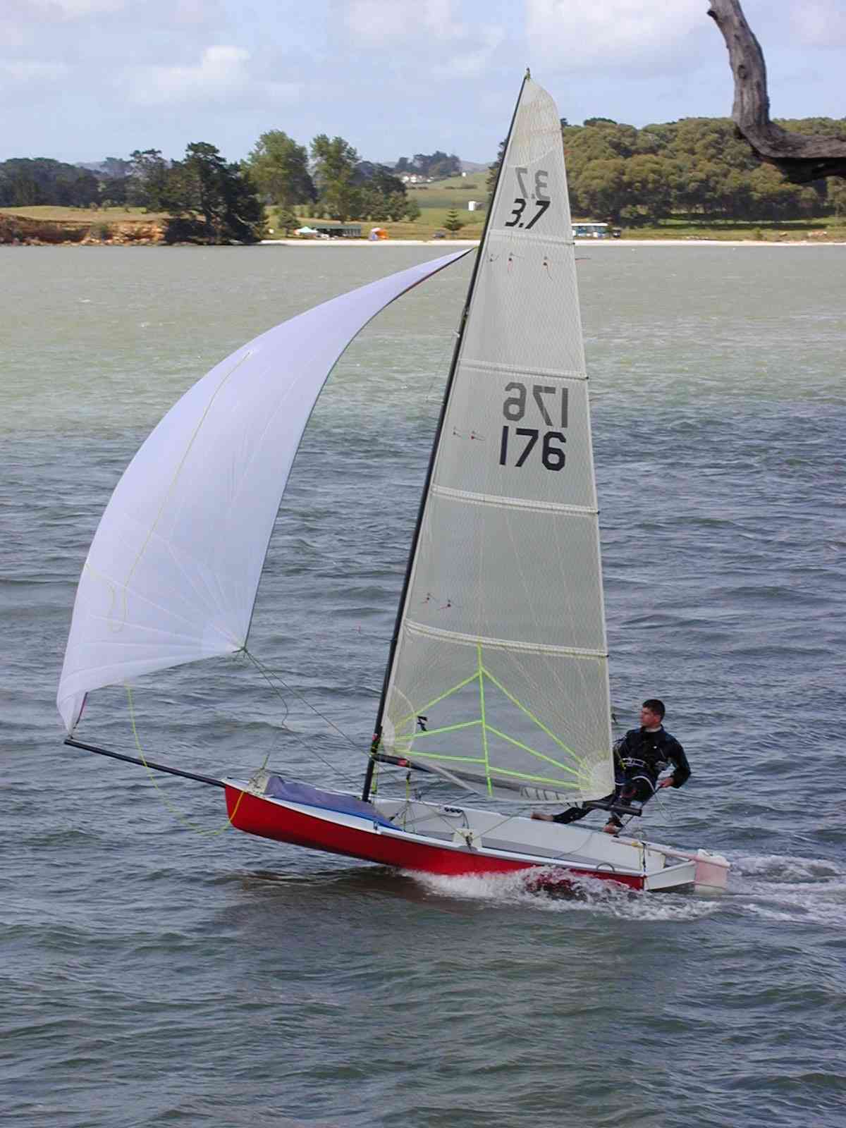

Post Options Post Options   Quote 423zero Quote  Post ReplyReply Direct Link To This Post Posted: 20 Oct 18 at 9:30pm
Image result for farr 3.7 sailing dinghy

Post Options Post Options   Quote Rupert Quote  Post ReplyReply Direct Link To This Post Posted: 20 Oct 18 at 9:05pm
As far as I can see, so long as there is no forestay in the way, there is no problem with this.
