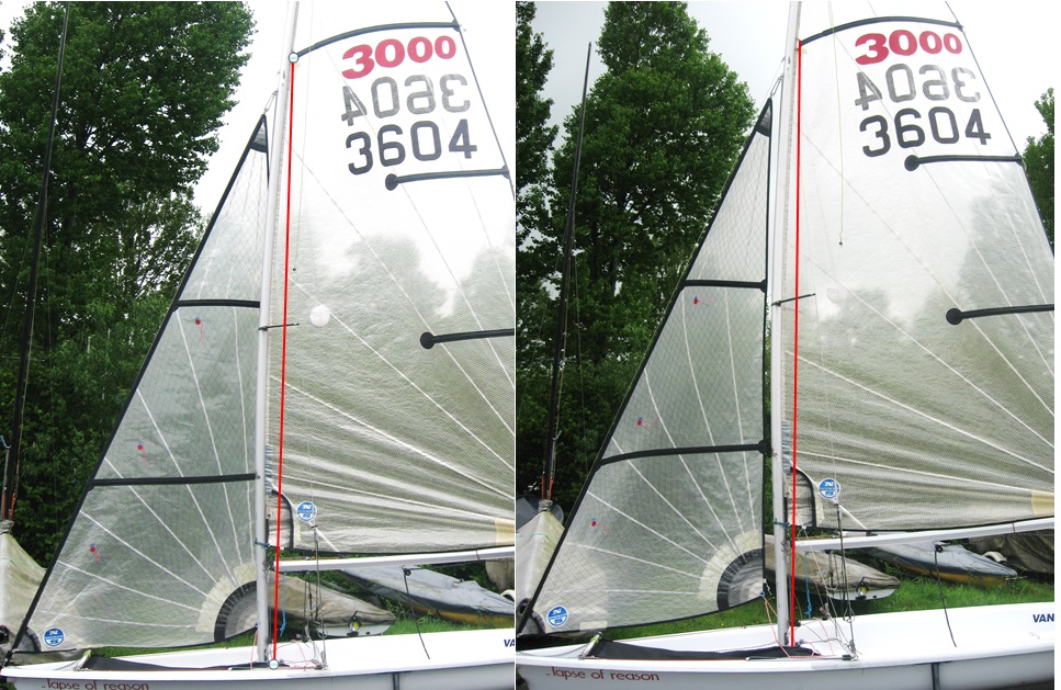

Post Options Post Options   Quote Medway Maniac Quote  Post ReplyReply Direct Link To This Post Posted: 27 May 14 at 7:24pm
The problem is not actual reverse bend at the gooseneck, but rather uncontrolled bend/movement.
If you push up on the end of the boom (to simulate wind loading), there is no positive restraint on the gooseneck moving back a little (not necessarily to reverse the direction of bend, but to reduce the forward bend you previously had).  With a conventional kicker, the gooseneck is held by kicker-induced boom thrust against the positive restraint of the lowers adjacent the gooseneck; the only way the sail clew can then move upwards is through stretch in the kicker or bend in the boom.
As a result, for a given kicker setting, the gnav will allow more upward movement of the boom (permitting increased twist) during gusts than a conventional kicker would.

Post Options Post Options   Quote NickA Quote  Post ReplyReply Direct Link To This Post Posted: 27 May 14 at 6:14pm
If anyone is still interested ................
Here are a couple of pics of my V3000 with nearly full mast rake and full GNAV on (more than I'd use when sailing I think) first without the lowers disconnected and then with the lowers on and coming tight at half GNAV.
The boom certainly does NOT move back (other forces won't let it).  Putting on the lowers moves the point of max bend (and minimum sail fullness) up the mast and also causes the GNAV to pull the leach in more.
Think my spreaders are swept back too far tho!
