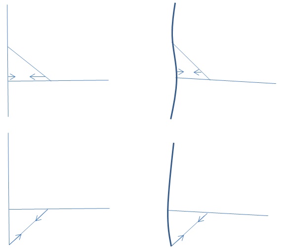

There is a difference. Vang pushes the boom down and forward. Gnav pushes the boom down and back. Both apply same direction bending moment to the mast, but applied at different heights. Replacing Gnav with Vang, or vice versa would therefore give slightly different result
Posted By: Medway Maniac
Date Posted: 17 May 14 at 12:41pm
Indeed, and that becomes significant insofar as you can resist the mast bending forward at the upper attachment point of the gnav using lower shrouds, but it is much harder to find a satisfactory way of stopping it bending back at the gooseneck.  You could use a baby stay from the foredeck to the gooseneck, but your jib won't thank you for it, and probably your original foredeck won't appreciate the loading either.  Thus the mast bend (and so leech tension) is only partially controlled.
For that reason I'd pick a conventional kicker over a gnav every time if the crew wasn't desperately short on space. I have a gnav on the V3k and my crew loves it even if I don't, but on the Laser 3k, I found I could do a lot just by moving the kicker attachment point on the boom forward, closer to the mast, and uprating the purchase to 16:1.  The boom was up to it (or maybe I was just lucky!).
Why a big boat like the Alto, carbon mast and all,  has a gnav I can't imagine.  Extra friction and extra cost that could be better put to a carbon boom that would be made more feasible by use of a conventional kicker.
Posted By: NickA
Date Posted: 18 May 14 at 10:24pm
Like THIS.    Hmm, maybe.
Certainly the point of force bending the mast changes (as I said in previous post) but the boom isn't actually pushed BACK just DOWN (the GNAV strut is fixed on the mast and slides on the boom).
Possibly the mast IS pulled back at the gooseneck, though I've never noticed it.  I guess the bit from gnav to deck is short and stiff so relatively unbending.  The main mast bending action comes from pulling down on the leach of the main sail anyway and that doesn't affect the bottom part of the mast so much.

Posted By: pondlife1736
Date Posted: 18 May 14 at 10:40pm
Not quite. It is a classical triangle of forces problem.
The gnav is a pin jointed compression strut. The force acting along the strut can be resolved into a downward (vertical) force and a (horizontal) force pulling the boom backwards. Your diagram is shows only the horizontal component. Friction will alter either the vertical or horizontal component depending on design.
The vang diagram is correct though, although the resolved forces aren't shown.
Date Posted: 18 May 14 at 10:43pm
I hasten to point out that the "centreboard case" to which NickA refers must be on his Javelin!
Diagrams reflect my understanding of what goes on.  Whether you regard it as the sail puling up on the boom end or the boom end pulling down on the sail is immaterial.  Either way, using the gnav the mast is being bent by a pull at the gooseneck and a push at the upper gnav attachment point, instead of at the mast-foot and gooseneck, respectively, when using a vang.
Posted By: NickA
Date Posted: 19 May 14 at 1:15pm
You can work out the resolved forces yerselves.  I only showed the initiating force!
Have to remember that the fixed points are the mast foot and the tops and bottoms of the shrouds; everything pivots around those.
Shall meddle with my GNAVed boat and send photos; I'll be surprised if that bi-directional twist is significant compared to the bend induced by the boom pulling the leach down - but in a spirit of inquiry will be pleased to be found wrong.
Date Posted: 27 May 14 at 7:24pm
The problem is not actual reverse bend at the gooseneck, but rather uncontrolled bend/movement.
If you push up on the end of the boom (to simulate wind loading), there is no positive restraint on the gooseneck moving back a little (not necessarily to reverse the direction of bend, but to reduce the forward bend you previously had).  With a conventional kicker, the gooseneck is held by kicker-induced boom thrust against the positive restraint of the lowers adjacent the gooseneck; the only way the sail clew can then move upwards is through stretch in the kicker or bend in the boom.
As a result, for a given kicker setting, the gnav will allow more upward movement of the boom (permitting increased twist) during gusts than a conventional kicker would.

The V3000 has the boom joined to the mast using a hole and pin arrangement (as do the Vago and RS500 tom name but two)
http://www.seldenmast.com/en/products/dinghies_only/booms/gnav_system/__lang_en.html
This is SO much better than the standard "square pin into the boom" of a traditional boat in that the boom can never come off the gooseneck.
I wish we had the same arrangement on the Javelin on which the boom is only held on to the mast by the outhaul and kicker (which are not always tight).
I guess a GNAV will work better on a boat with a low boom EG a musto skiff - though I think the boom is at deck level to maximise low down sail area rather than to maximise GNAV efficiency.
Partly fashion, partly ergonomics, but evidently little difference in performance given by the variety of boats using the two systems:
Vang:  B14, RS800, RS700
Gnav:  49er,  i14, Laser 4000, MPS, RS500
Interesting to note that the mast does bend in a different place under GNAV and VANG, pulling fullness out of the sail in a different place; so sails cut for one may not work their best with the other.  (The V3000 sails were cut for a GNAV presumably).
