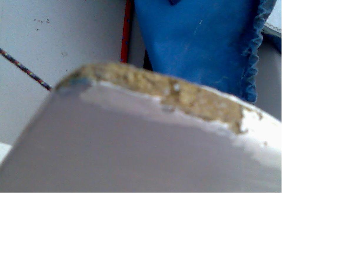

No doubt I am not the first to damage a daggerboard. I am new to dingy ownership (and thus maintenance) and have taken a chunk out of the bottom of daggerboard on my RS Vareo. The core is now visable and clearly in need of attention. Which capable of doing the job I am unfamiliar with either technique nor products. ANy advice gratefully Received.

Could you post some photos of the damage? The advice will be much more meaningful for you if we know exactly what the problem is
i'm sure we can advise on how to mend your dagger board but pictures would help a lot as it would mean we can tell which is the best meathod of repair for the damage

Thanks for the tip on Plastic Padding. However comment from Tim and Stuart make me inclined to post a photograph. I'll try and do that tonight. I think that there is about a 1x6cm exposure of the core. Many Thanks. |

Its not a great phot but you get the idea. Garry, many thanks I will see if I can find the Laser advice.
Pat |
Ouch!! expoxy and fillers me thinks!! make sure you remove any damgaed foam first or the whole repair will just fall off.
That looks like it has been repaired before to me and it is the repair that has come adrift.
As tack'ho says clear out any duff foam and then rebuild using epoxy and fillers. I Did that to a small hole in the bow of one of my Lasers and the boat is still going strong! |

Oops, seems I underestimated the damage! I don't think that one is for plastic padding. I hope you get it sorted ok & that you're back on the water soon! |
