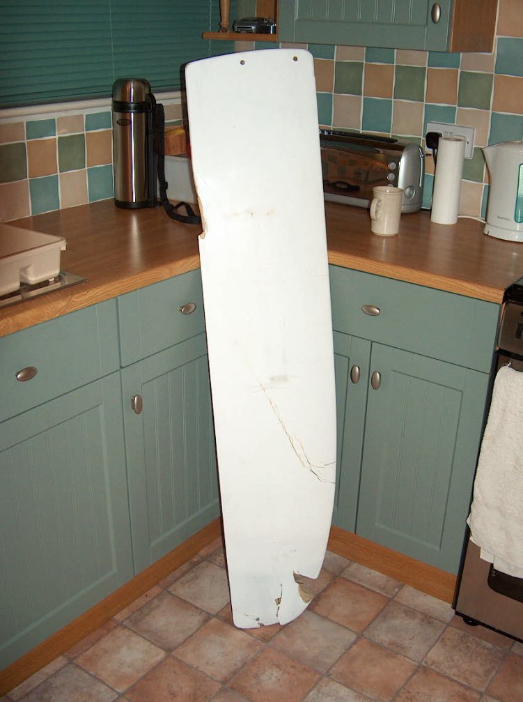

No doubt I am not the first to damage a daggerboard.  I am new to dingy ownership (and thus maintenance) and have taken a chunk out of the bottom of daggerboard on my RS Vareo.  The core is now visable and clearly in need of attention.  Which capable of doing the job I am unfamiliar with either technique nor products.  ANy advice gratefully Received.

Thanks for the tip on Plastic Padding.  However comment from Tim and Stuart make me inclined to post a photograph.  I'll try and do that tonight.  I think that there is about a 1x6cm exposure of the core.

 Its not a great phot but you get the idea.  Garry, many thanks I will see if I can find the Laser advice.

Posted By: tack'ho
Date Posted: 20 Apr 06 at 12:57pm
Ouch!! expoxy and fillers me thinks!! make sure you remove any damgaed foam first or the whole repair will just fall off.
Posted By: jeffers
Date Posted: 20 Apr 06 at 3:49pm
That looks like it has been repaired before to me and it is the repair that has come adrift.
As tack'ho says clear out any duff foam and then rebuild using epoxy and fillers. I Did that to a small hole in the bow of one of my Lasers and the boat is still going strong!

Oops, seems I underestimated the damage! I don't think that one is for plastic padding.

Id agree with the "clear out any duff foam and then rebuild using epoxy and fillers" option but id like to add that it should be done with an angle grinder or similar high speed powertool, none of this pansy 'carefull removal'  stuff....

Isis, i agree. If you don't have access to an angle grinder then use a belt sander with 60grit paper. Take the board down to a point where there is no more damaged foam and then make a thick bog using epoxy resin, microfibres and maybe some colloidal silica to ensure you have a thick enough paste so it is easy to work with.
Let this go off and then start sanding back to the right shape. (best bet is to leave at least one end of the board the right height so you have a base mark to work to.)
When you are nearing the correct shape then you might want to use a lighter mixture of fillers so you can sand it more easily as it will be a little softer. Maybe some ultralite fairing fillers or simply some micro balloons.
Sand till very smooth... sell boat... buy a cherub... go sailing
(ps that is what i would do, i have limited experience so stand to be corrected by anyone with a better idea!!)

to be honest what tim has just said is exactly what i would also do, just remember be brave it may sound a bit extreme or risky taking an angle grinder to your foils but its the only realistic way you can get a good strong repair.
