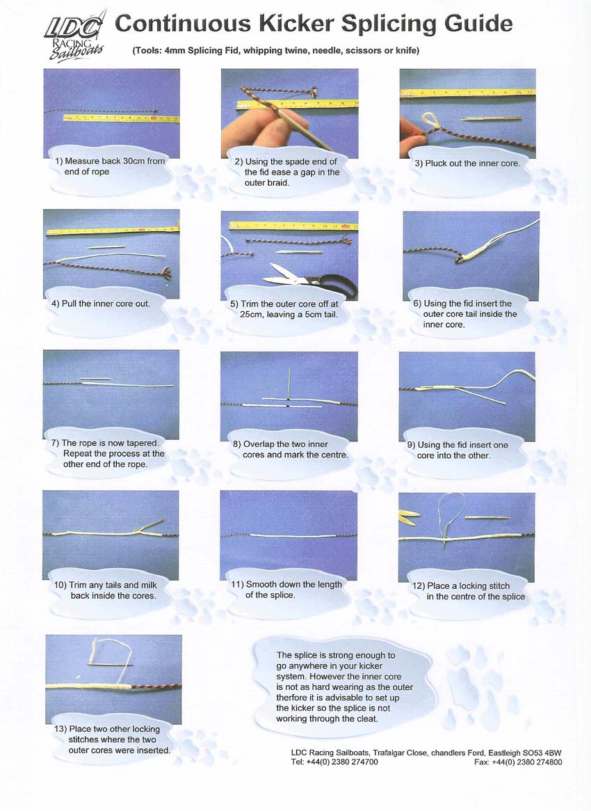

I'm currently putting in new cleats to my boat, and want to upgrade to
continuous control lines, and was hoping somebody would be able to give
me some advice about what's the best rope to use for that purpose, and
how to splice it together.
Thanks in advance |

Hi Charlie,
Not sure what rope I have on the Blaze but it is made continuous by the ends being sewn together then whipped. not sure how strong this is likely to be so I try to keep the join in the non load bearing part of the line. Paul |
search the RS class websites there is an excellent step by step guide to doing it on there, if i get time later ill have a look to try and find it for you
tornado435 ![]() Posting king ![]() ![]() Joined: 05 May 06 Location: United Kingdom Online Status: Offline Posts: 196 |
On the tornado I use excel pro or racing, always get it mixed up. The one where the inner is weaved together rather than twisted. just cut away a length of the outer and splice together like you would D12 or Vectran, using a fid. easier to see than explain. no knots no twine, it grips together by itself but can be easily undone. I have a continuous downhaul and jib sheets that need to be taken apart every time I trail the boat. |

We normally use 4mm Excel Racing, however any plaited cored dynemma should work. We have used 3/3.5mm D12, however it doesn't work in the cleats as well when under high load. Also it is harder to pull on.
Edited by Adam@LDC |
Retail Manager, LDC Racing Sailboats
Charlie, I do the same as jeffers. I strip back the inner core by a couple of inches so that there is less bulk to the ends and then sew them to gether before whiping to make them roundish. As long as you are thorough in your sewing and whipping it should be more than strong enough. It's also easier that splicing and you dont have to have braided core rope to do it. |

Thanks for the replies, i think i'm gonna go with the braided core approach with 5mm rope as it looks the strongest join, and with the Finn once you've joined the lines you almost never need to undo them.
