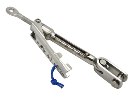

Bluewave turnbuckles have three (maybe 4?) advantages over a Vernier chain plate
1) More precise 2) Can be adjusted under tension with no additional tools 3) Can be adjusted without removing a shroud pin (safer on water) 4) Harder to accidently remove (never actually had this happen to be) A two row Vernier is enough precision on shrouds and caps for me. But a bottle screw would be nice on lowers where smaller adjustments make greater changes to tension. However, this could be achieved with a regular bottle screw. 2 and 3 are only really plus points if you want to be changing settings between races. Good when I was sailing 29ers and 49er and we'd have 4/5 race days with 10 hours on the water. But in amateur stuff with 2/3 race days and 3/4 hour days I am happy to set and forget. Point 4 I am not sure is a point. So overall they are a lot of extra expense for not much benefit. I would like bottle screws for lowers though, but a cheap set without in built spammers would suffice.

Me I wouldn't use an expensive thing like that bottle screw..
I use String.. As do many keelboats on the Norfolk Boards. Tacking on the rivers you don't have time to do adjustments to the shrouds during the races, unless you fit a block and tacky beneath each shroud, and then you'd have to be sure your jammers are failsafe.... So this year it's about 5 turns of 2mm Dyneema round the U bolt which is the stay plate and also through the rigging Eye. I'll inspect the string regularly and change it if required. |
