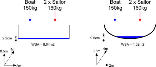

You're assuming that waterplane area doesn't change with the extra immersion. On the flatter boats it can increase spectacularly.
I thought about this and did a few rough and ready calc's to see if that true.
Imagine 2 boats that are 4m long, 2m wide and 0.5m deep.  Both have constant section along there length (see assumptions/disclaimer at the end) to make the lunch time maths easier.  Both boats weigh 150kgs all up and the crew weigh 160kg all up.  One is box section the other is round bilged
The box sections draft would be 2.2cm in salt water and the round bilge would be 9.5cm, nothing revolutionary there.  The STATIC wetted surface area (WSA) is 8.04m2 for the box and 4.52m2 for the bilge

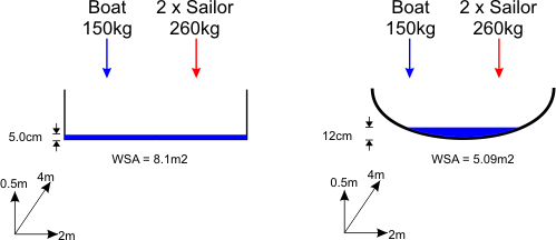

Now if both crew members ate the pie diet and put on 100kgs between them the draft would be as follows:
So for the box section the draft has increased by 127% (2.8cm) and the bilge has increased by 26% (2.5cm).  The interesting bit is WSA, the box has increased by 0.7% whilst the bilge by 12.6%.
So by eloquent and logical deduction, box type craft, i.e. little or no rocker, large flat planning surfaces can carry weight better as the WSA doesn't increase greatly as it is already high (hence high drag as sub-planning speeds).  Where as round bilge or tradional designs suffer higher WSA's as weight increases and hence more frictional resistance as weight increases.
