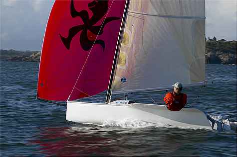

Originally posted by Ian29937
Rather than lifting the 'oh so fine' bow that kite looks like it is trying to bury it into the next wave.  I'm sorry, but it looks like a disaster in the making...
Spinnakers don't lift the bow in any circumstances, its a popular myth. They can lift the *boat* but they depress the bow. But lifting the boat does reduce pitchpoling.
If the kite lifts the boat and the Center of Gravity is behind the point of lift then that will effectivly lift the bow
wether the kite lifts the bow all depends on the ratio between the length of the mast and horizontal distance between the mast and the end of the pole. The shape of the kite and the position of the kite sheet reletive to the CofG also makes a difference.
The very flex forward mast with the asymmettric is certainly unconventional. Thinks, when a gust hits, the rig goes forward, centre of effort goes forward and the boat bears away automatically... I guess it has its points!

Ummm.... that's what made me think that the STEALTH is a 'Super Size'
MX-Ray. Cos the Ray was a bit small with a narrow water line for BIG
Amercans, which maybe one of the reasons it didn't take off. The Ray on
the other hand does have a fractional Asymetric rather than a masthead
kite like the STEALTH, which could be a mistake on an unstayed mast. But
then again that could be one of the reasons for the odd main sheet
arangement. Maybe using leech tension on the main to back stay the
mast head?!!??? and put the loads back into the mast foot??? I'm not sure
about it and that's coming from someone that's got an MX-Ray    [:

When you just notice helm position upwind on the first pic and mast behaviour downwind I would say this boat will be a nightmare.

I suspect it's sailed on the great lakes where there is not much wind.
Can you imagine that in 25 knots at Lymn Regis ... dive, dive dive ...
