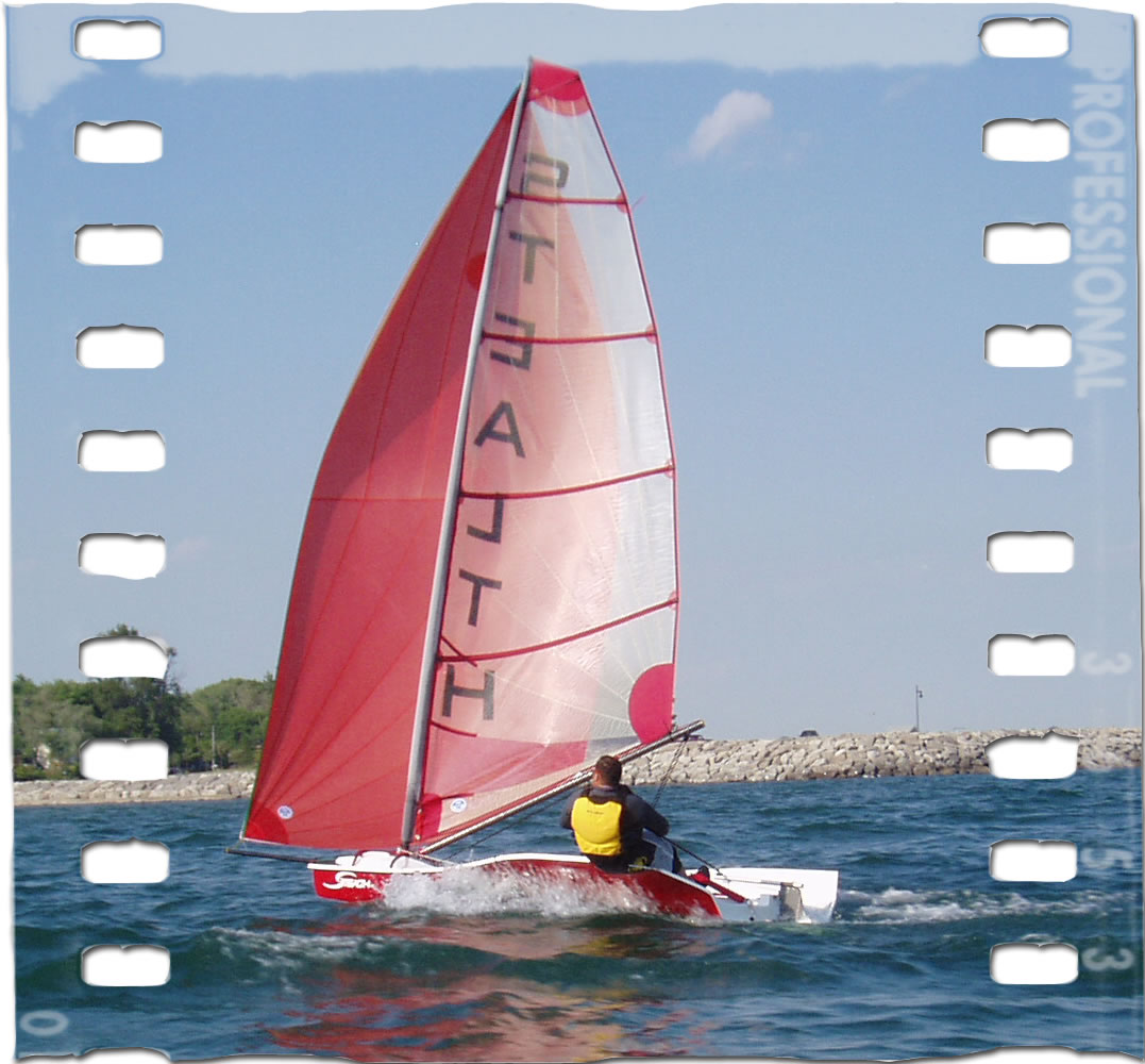

Looks like someones got hold of the MX-Ray design and done
something odd / interesting?

no i think it has a board rather than a keel

What do you think of a huge main without shrouds ?

Very weird looking mainsheet set-up, can't quite work it out, looks as if you sheet from the bottom of the mast.
http://www.vaxxine.com/clsailboats/stealth/develop/images/stealth%20002_jpg.jpg">
Posted By: tgruitt
Date Posted: 28 Jun 05 at 5:07pm
looks way too easy to pitch pole to me!
Posted By: Chris Noble
Date Posted: 28 Jun 05 at 7:57pm
almost too easy, just looks as if its always trimmed slightly too far forward

Re the unstayed mast comment before...
Is it just the angle, or does the rig seriously invert with assymetric up?

there's not much freeboard at the front and  un stayed mast with masthead kite looks a bit wably.
Posted By: Ian29937
Date Posted: 28 Jun 05 at 10:18pm
Rather than lifting the 'oh so fine' bow that kite looks like it is trying to bury it into the next wave.  I'm sorry, but it looks like a disaster in the making...

When you just notice helm position upwind on the first pic and mast behaviour downwind I would say this boat will be a nightmare.

looks like a curvy P7 from the back that last one! With that first boat you have to wonder what the ideal crew weight is as that helm isn't exactly the peak of physical fitness. or is he the average US sailor?!
Posted By: Jack Sparrow
Date Posted: 29 Jun 05 at 12:36pm
Ummm.... that's what made me think that the STEALTH is a 'Super Size'
MX-Ray. Cos the Ray was a bit small with a narrow water line for BIG
Amercans, which maybe one of the reasons it didn't take off. The Ray on
the other hand does have a fractional Asymetric rather than a masthead
kite like the STEALTH, which could be a mistake on an unstayed mast. But
then again that could be one of the reasons for the odd main sheet
arangement. Maybe using leech tension on the main to back stay the
mast head?!!??? and put the loads back into the mast foot??? I'm not sure
about it and that's coming from someone that's got an MX-Ray    [:

Spinnakers don't lift the bow in any circumstances, its a popular myth. They can lift the *boat* but they depress the bow. But lifting the boat does reduce pitchpoling.
The very flex forward mast with the asymmettric is certainly unconventional. Thinks, when a gust hits, the rig goes forward, centre of effort goes forward and the boat bears away automatically... I guess it has its points!
