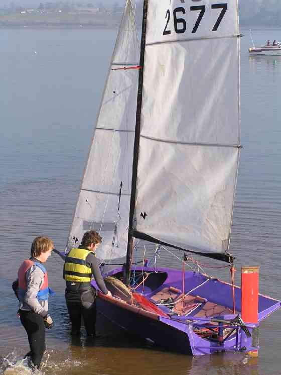

The one that looks like this ...
7 Feckin hywwggffrr big spynnnyyrkrr stypdd skyffff fffyfffe kyytte
(OK - its only a No. 2 rig, but...)

Picture taken at the Draycote Blast in Naff all wind

I'll save myself by being pedantic.....If it's a Cherub with a 12' skiff rig, it's not a Cherub but a 12. Throwing 12 rigs on Cherubs was been an occasional trick for years. One got 3rd in the 12' skiff nats not so long ago.
