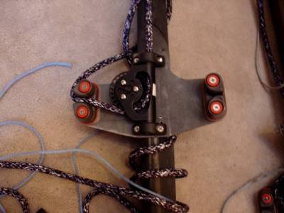

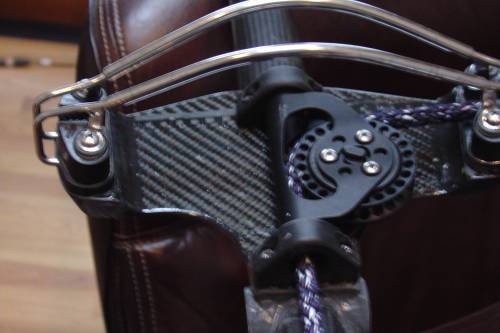

Dan, It's good to hear from you and to see you getting it wet. We should have a lot of fun this summer in the Seattle / Vancouver area with so many new Swifts coming on line, your boat, and some Mustos. Single handed skiff sailing is the future of sailing (this statement should be good enough to fan the flamers a bit--don't you think) I appreciate that you've had the balls to have a go at it. I'm sure you've also found that S/H skiff design requires new thinking and that makes it an exciting exercise. I believe that the integrated systems that SH skiff designers will design out of necessity (the mother) over the next couple of years will have significant application to other dinghies. I saw that you were going to a on boom cleating system and wanted to share a couple of photos with you. I had tried the typical head knockers and some other systems but found the one in the picture to be head and shoulders above the rest (these are unside down) It does need to be placed fairly far forward on the boom and the angles from the Fredriksen ratchet to the cleats take some tweeking to get just right, however, once you get it there, I think you'll be convinced. The second picture is an addition to help those with less patience because, theoretically, the angle will be more forgiving. I've not actually sailed with it yet. If you want to try this sytem the dimensions are in the Rigging Guild on swiftsolo.org. The second system is made up from Servo cleats with the addition of some 1/8" ID thinwall stainless. You don't even need to weld the tubing--just slip it over the cut ends of the Servo guides. Best of luck and I look forward to sailing with you in the summer. Let me know when you want to come down and we'll put you up. I do live an hour from Shilshole but I'm driving there most days anyway. Bram |

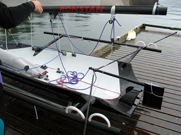

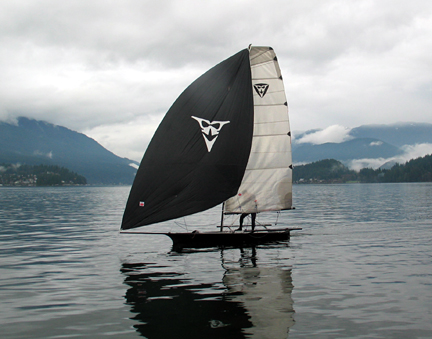

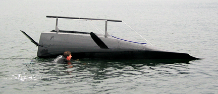

Bram, It'll be great fun, and don't worry..we'll pick you up on the way to Shilshole. I have to say I really admire all you've put into the S/S, all your years of experience and innovative talents are there to appreciate. Can see what you're doing with the mainsheet system. We just got ours hooked up the other day so I don't have a closeup, but I think you can se it in the photo. It's similar to yours, except that we have cheek plates with a cam cleat mounted on them so it swivels with the bail. Ours would be lighter and works well so far, but we'll see how it works in heavier air. You can also see the vang and downhaul led to the racks with bungies taking up the slack. The photo below shows you the hull underbody. Safe to say we've gone in different directions here, which brings me to another point. Boats are like food: one man's meat is another man's poison and people forget it's all about fun. There is no better or worse for everyone, just individual preference. People should get out and sail as may types as they can, just as they should travel to other lands, experience other cultures. There may well be no place like home, but how boring if we were all the same. Cheers, Dan |

Dan, It looks fast. We will have some good fun this summer! Your mainsheet fitting is the style that I had tried. It is lighter and you can buy it in the store! The issue I had with it was that I needed to move far aft when it was blowing above 15 before initiating the bear away in order to keep the nose out. It wouldn't let me do it. (may not be a problem on your boat but I'd have to guess that it might be). The problem with my system is that it requires a hard vang in order to keep the boom from rotating (for obvious reasons). On the other hand, the eccentric cam lever is actually quite light, powerful and simple. Anyway, if I can help in any way, contact me at bdally6107@aol.com. We'll likely bore the crap out of these guys by discussing this kind of detail here. Best regards, Bram |

The shape of the bottom looks like she'll be blazing fast up wind but you had better get off the bow if you want to turn fast.
I have a kayak I built that has a thin bow like that. I tracks great but turns like the QEII. |
