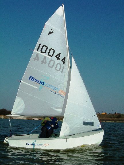

I would have thought a Heron would do the job.

Better that a Skipper anyway. A least you can put a decent rig on it. A Gull would be another possibility although the Gull's boom is somewhat lower than the Heron's boom. Being double chined a, Gull's a bit rollier than a Heron too. |

Both Gull and Heron are fairly small for a 100kg guy with movement problems. A GP14 with reefing points in the sail might work well.

My rational for the Heron was: Yes small for a 100kg guy - but: stable, high boom, lightish and helm isn't that mobile so the small size would, I guessed, be a benefit. There is a inherent difficult in the problem i.e Larger, stable boats are not light. But yep it might be better to go the GP route as you suggested and live with the weight of it. And or modify a launching trolley to help with the weight, by adding a jockey wheel to it. |
