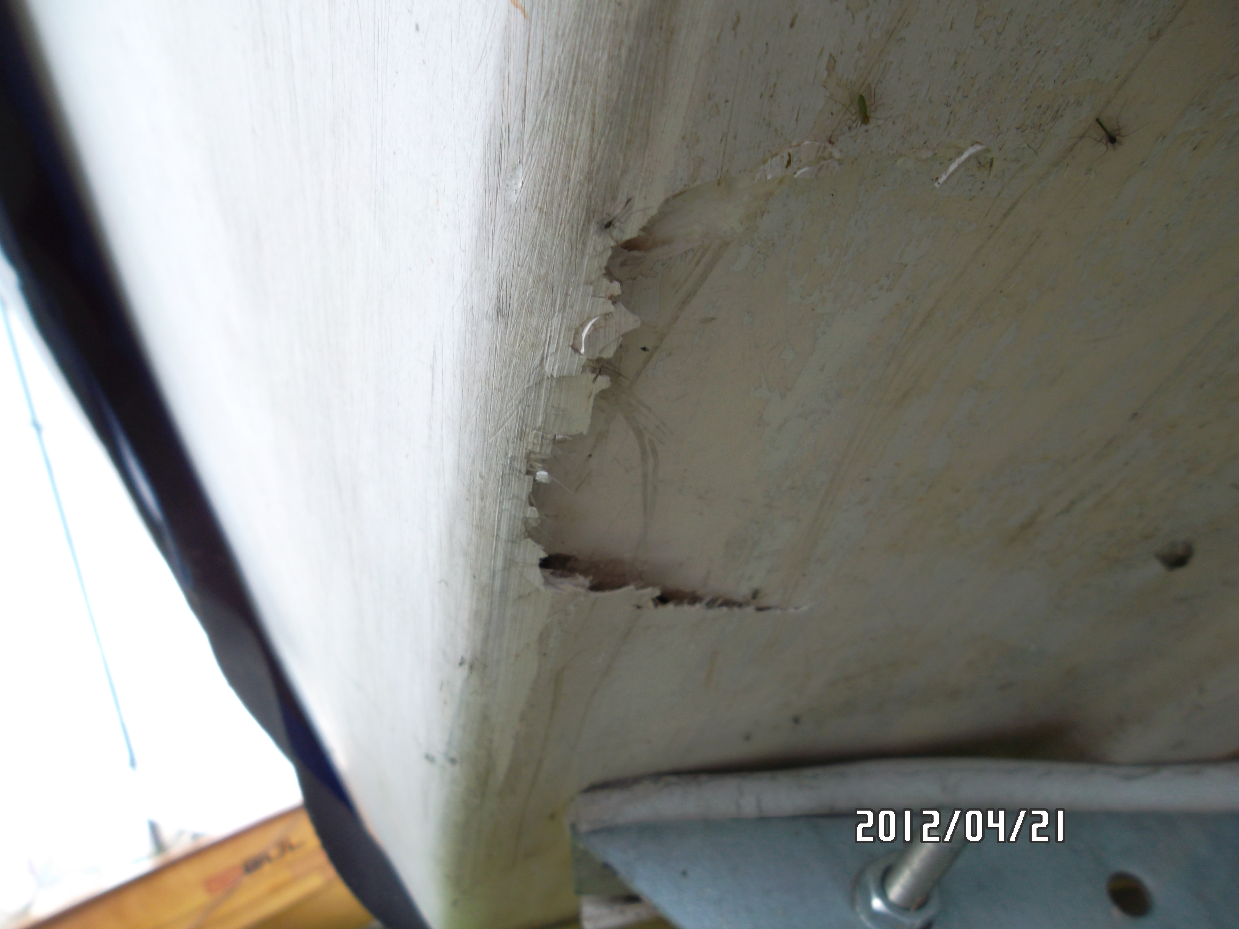

Hull Repair GP14 |
![]() ![]() ![]() ![]() Posted: 25 May 12 at 11:08am |
A better way (if you undo all the work you've done already) is to open out the hole big enough to fit a glass patch through (if a flat panel, you can make it on a board, then cut it to shape) which you the bond in place, much as you would a piece of ply on a wooden boat. You can then build up your repair on that from the outside.
you'll need to put a hatch in really. if you message Jeffers he did just such a repair on one of our club boats last year.
