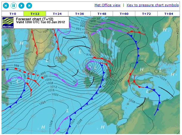

On a low pressure isobar, the wind runs anticlockwise along the isobars rather than parallel.

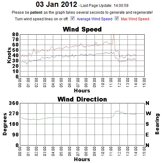

Mmm. Picture paints a thousand words and all that. To be honest I didn't appreciate the wind blew parallel to the isobars. Presumably the spike is equivalent  of a bow wave?

The spike coincides with the cold front passing over.  In front of the front (blue) the isobars are close together (high wind), as the front passed the wind veers more to the West and the isobars are more spread out (lower wind).

This is windy Weymouth this morning. You can see the wind gradually building through the morning then a big spike at 79.4kts(!!) followed by a sudden drop and a swing in direction. What causes the spike?
