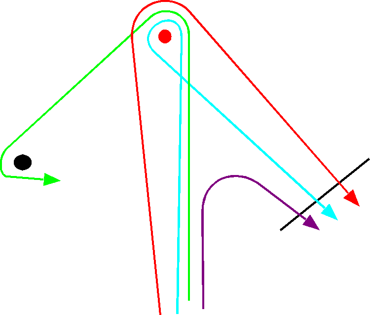

Hmm. not quite clear about this. Is this sketch roughly right as regards the situation?
Green being the course that was set, red being the course that was actually sailed? It does depends completely on the SIs etc, but unless there is something very specific going on I think it depends on whether the mark was defined as a rounding mark or a passing mark. I believe the default is a passing mark... ![]() In that case, if the port hand mark is a rounding mark then the string rule applies, and cyan is correct. If on the other hand its a passing mark then competitors would be within their rights to sail the purple course and peel off to the finish as soon as the shorten flag appears, because they will still have left the mark to port. For red to be correct there would have to be something quite complicated in the SIs I think. But clearly red was the sane thing to do in the circumstances! Edited by JimC - 31 Jan 11 at 6:43am |
JimC, Nice visualisation and nice diagram.
Yes, marks are only rounding marks if they are identified as such in the SI (rule J2.1(5) and Appendix L note to 9.2, and RYA Appeal 1985/4).
RYA 1985/4 When a race committee intends a mark to be looped, the mark must be identified as a rounding mark. When the sailing instructions do not do so, or when they are ambiguous, a boat may elect not to round a mark when she can still leave it on the required side and in the correct order. |

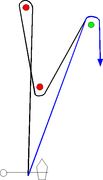

Wind was shifting, and there had been several course changes on the beach while rigging. RO tried to set a "one of these will be a beat" course. The windward mark was originally stbd: once many people had launched it was changed again to port as per sketch, with black being the intended course. We don't use passing marks, so have no way of distinguishing passing marks from rounding marks on the CB.
Protest was about some sailors having missed the change from stbd to port rounding and rounding incorrectly, but once we analysed the situation we realised that blue was a legal course... ![]() Edited by JimC - 01 Feb 11 at 12:21am |
I remember you told us before that at your club you do courses with a marks and a string on pegboard in the clubhouse.
Assuming that your SI say something like 'courses shall be as shown on the course board in the clubhouse', if the pegboard had an actual string touching the marks, that, in my opinion makes them rounding marks. No less so for a chalk line or whiteboard marker illustrating change of course at each mark. On that basis, Blue isn't the legal course.
