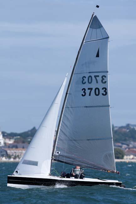

All I know is today our mast was raked back further than it's ever been
(partly from stepping the mast in a hurry and not rechecking the pins)
and with the wind in the upper teens we were stonking along. Properly
planing up wind and even won the race both on the water and on corrected
and that's never happened!
![]() RAKE! |
I tend to agree I've always thought that the most significant factor is that raking the rig lets it all breath better, jib slot opens up, spreaders let the mast bend more etc etc. The flaw in this theory however is that raking still works for a single sail, unstayed rig... so basically what i'm saying is that I don't have a clue either! Ian
