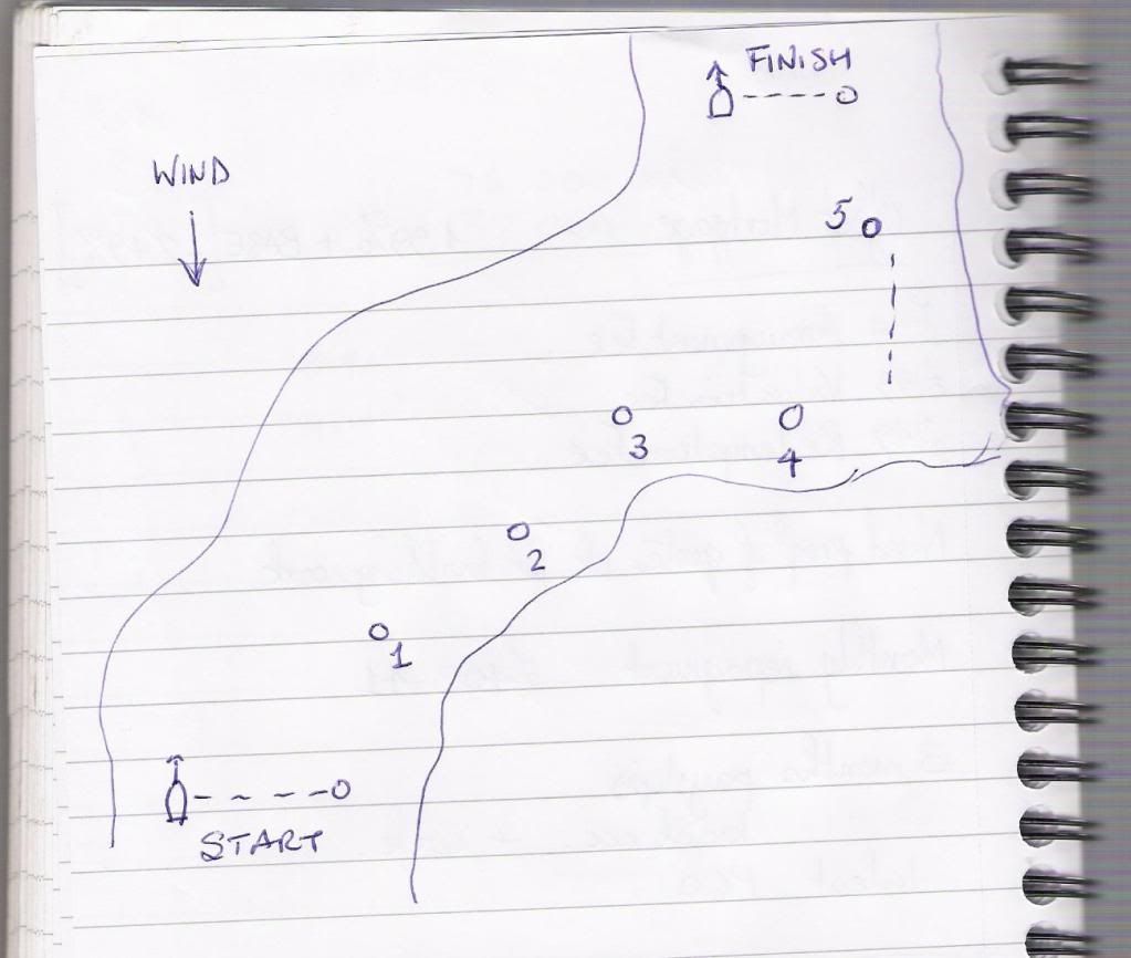

A strange situation cropped up in a recent race at our local club, regarding the interpretation of rounding a mark.
Here's a variation of the course which illustrates the point of contention.
The OD sets the following course (see diagram)
(START)
1-S
2-S
3-S
4-S
5-P
(FINISH)
What does a boat need to do at marks 2 and 4 in order to correctly comply with the stated course?

Post Options Post Options   Quote Sailing4Life Quote  Post ReplyReply Direct Link To This Post Posted: 07 Aug 10 at 11:46pm
To me with the diagram you have drawn and the instructions
you have given I would leave mark 5 to port and that would
be it. You leave mark 1,2,3,4 to starboard which means as
long as they are on your right your good.

ohFFsake View Drop Down
Joined: 04 Sep 08
Posts: 219
Post Options Post Options   Quote ohFFsake Quote  Post ReplyReply Direct Link To This Post Posted: 08 Aug 10 at 12:13am
That's what I thought.
However to satisfy rule 28.1(b) it would appear that the only correct interpretation would be to do a 360 degree clockwise turn around marks 2 and 4.
Otherwise the notional piece of string fails to touch the mark

The exact situation in our case is that 3 marks were defined as in 3,4,5 above. I chose to go straight from 3 to 5, on the basis that I thus passed the correct side of 4. I won the race but a week later our sailing secretary came across rule 28.1b and retrospectively DSQ'd us! Thus it would please me greatly to find we were in the right all along!
