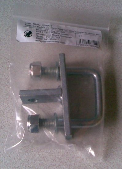

It might fit, but you might need to remove the front fitting off the road base and replace it with this:
![]() The important thing is to ensure that the rear of the roadbase engages with the trolley. I would definitely want to see how it fits before you start making changes. Nigel |

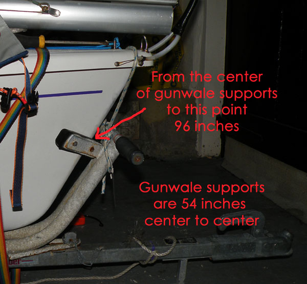

Nev I'll measure up my L2 trailer tommorow AM and post the dimensions. |

Hope this helps Edited by GK.LaserII |
