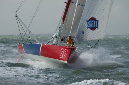

Could anybody explain the reasoning of using outriggers to support the rig on some single handed ocean going boats - such as Sill.

Arent they like a fat set of spreaders giving a wider base to support the mast?

Guessing that the wider platform gives a number of benefits :
1, Being wider and with a "prodder", some of the shroud load can be converted into sideways compression load instead of tension "up" load.
2, Gets the side rigging/shrouds out of the way and so you can have more room around the boat for running rigging / lines etc
3, Further benefit of having the side rigging/shrouds further away from the boat you create a larger set of triangles to move the load around and generally provide more stability - this may also help with some of the boats that use wing masts (maybe)
Just my late night Sunday guesses...

I was wondering if the wide base that this system provides maens no need for spreaders and hence a rotating mast can be used.  We really need an expert to clear this up.

having deck spreaders reduces the downwards pressure at the hounds, and it is changed into more of a sideways tension. This in turn letsa the mast rotate easier than with normal rigging arrangement.
To make it easier imagine sticking a multijull rig on a mono, the deck spreader replace the outriggers.
hope this made sense.
Rig changes are allowed whilst racing on the Melges24 and Etchells (i think), and generally boats like the farr40 and kerr11.3 will change thier rig between races (I know I have to do it if the wind changes more than 5 knots)
