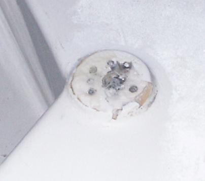

The mast steps on my 600 is all cracked up and dodgy looking so I've taken the metal bit off it and started looking at what i can do to make the structure better. There doesn't seem to be much I can do short of taking the hole lot off and rebuilding it, which is beyond what i was hoping to do and probably beyond my abilities of mending stuff. I have currently removed a lot of gelcoat that was put on there to cover up the cracks by a previous owner, and i have also removed some dodgy, wet filler that wasnt really bonded to it anyway, now I'm wondering what to do next. I will post some photos here tomorrow when there is some light but in the mean time any sugestions are welcome.

Send a photo, but most likely remove all the cracked up rubbish and replace with multiple layers of epoxy and glass or carbon, as much fibre and as little resin as you can manage whilst still keeping it all fully wetted out. Weigh the whole lot down with loads of weight and some peel ply to tidy it up, sand flat and replace fittings. If you can possibly through bolt the fitting do so. Care and attention will be more important than any spectaculat degree of skill. If its wore than local cracking then its a bigger deal.

Normally the cracks in the area are just superficial cracks in the gelcoat. The problem is that when underload there is a bit of give in the structure but the thin layer of gel-coat is relatively brittle and so cracks.
I would clean up the area under the mast foot, then remove any gelcoat locally thats cracked or not fully bonded down. Replace the mast foot with a suitable sealant layer below, and then build the gelcoat back up to the edges of the mast foot. I would recommend stopping short of the mast foot itself by a few mm and then filling the gap with something flexible like sikaflex.
If however the structure below the mast foot is soft, Id get it back to LDC for a professional repair as the bulkhead may need re-building.

Right, more info. It is not just gel coat. The epoxy or whatever it is it's made from has a couple of chunks missing out of it but there are large areas of it that look fine. Having got inside the hull today with a camera, there doesn't appear to be anything wrong with the bulkhead and the damage is restricted to the raised part with the step on it.
What is peel ply you refer to Jim, I have heard you speak of it before but a bit of googling leaves me none the wiser, what is it? where can I get it? how should I use it?
Finaly here are some pictures of the mast step, they aren't very close up and detailed as there wasn't enough light left when i got home today to get any good close up picks. So here are some to give you an idea but I'll try to get some better ones tomorrow.
That seems to have come out OK actually. You can see the chunk missing next to the furthest right screw hole. There is a clear layer of filler over the top which is why you can see 6 screw holes as oposed to the normal 3.

Not really enough clarity, but I wouldn't be altogether suprised if that isn't mainly gel coat damage... Are there fibres sticking out/cracks obviously going through fibres? If not its just a question of cleaning up all the bits, removing all dross (acetione could be a useful solvent) and building back up to shape with something very strong. You could possibly use gel coat again which would be prettiest, but I think I'd probably mix up some epoxy resin with microfibres and silica.
Peel ply is a nlylon fabric that soaks up excess resin and is then just peeled off the laminate when its cured. For what you want you just need an offcut from your local friendly boat builder - everyone has odd scraps that sort of size left.

Yeah it looks how I imagined it to be, ie superficial damage. The small chunks of epoxy that have come away near the fastener holes are not really a problem, but clean it all up dig out any suspect or cracking bits and re-fill with epoxy and colloidal silica or microballoons. You can then cover this neatly with a thin film of gelcoat just to bring it back to original condition.
As Jim says peel ply is great but for the size of area you are looking at I really dont think you need it. Slightly overfill the areas and file and sand it back before applying the gelcoat.

Yeah im at HHSC, I think ill be fine fixing it with either microfibres of some glass tape to build it up. I've now got all the crap off and unfortunately it wasn't just superficial cracks, most of it was just gel coat filler undearneath and the cracks went right through it so i took all the gelcoat and some of the original material off as that had cracks in it also (it could have been more slightly different coloured filler though). I found some of the old screws left in the glass as well. I'm going to wait until ive got hold of LDC about the other problem before i start any repairs on this bit though (hopefully it will be a bit warmer by then too).
