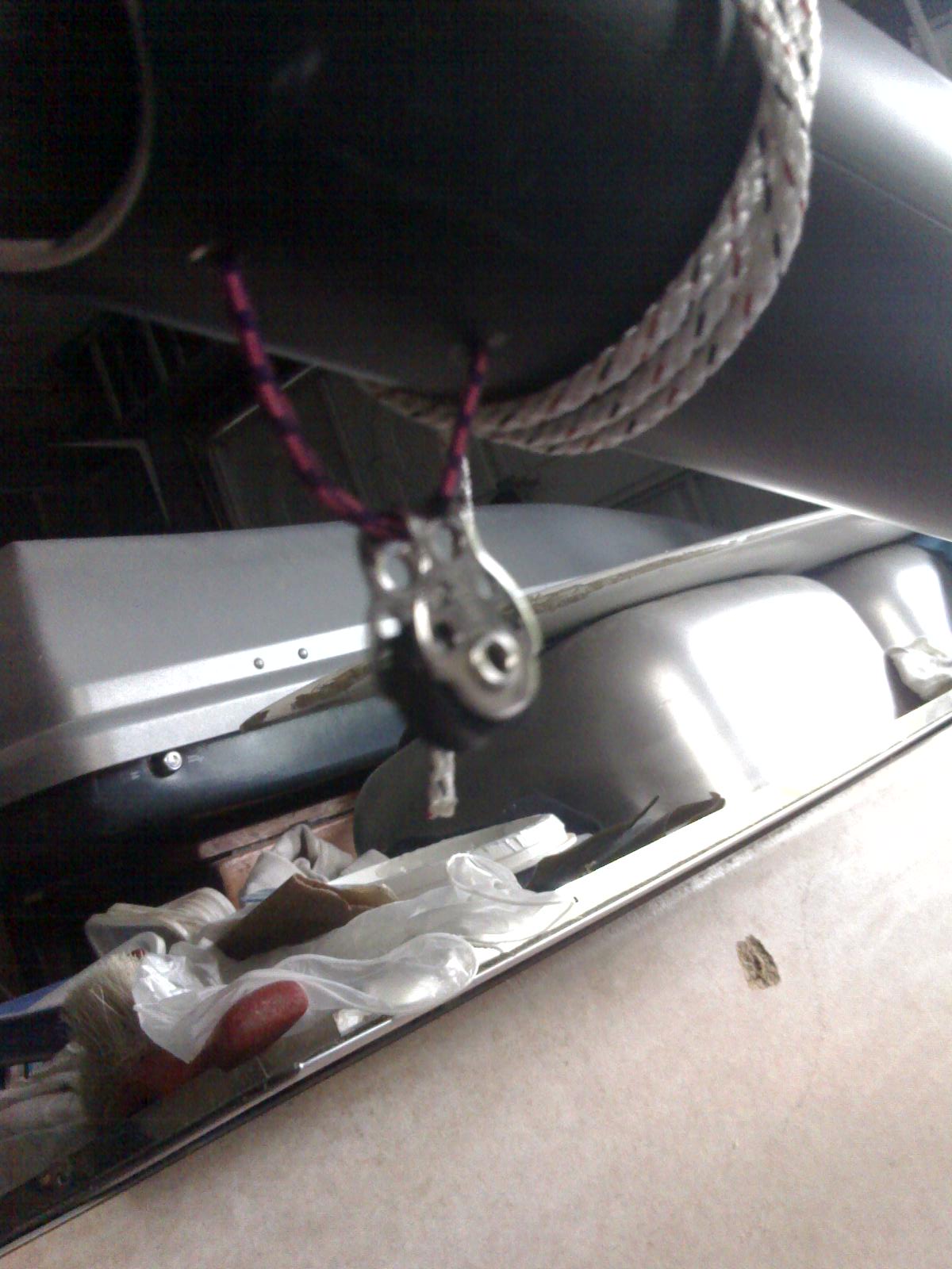

Post Options Post Options   Quote tmoore Quote  Post ReplyReply Direct Link To This Post Posted: 26 Jun 08 at 9:31pm
this is what i meant, will it be ok?

Post Options Post Options   Quote JimC Quote  Post ReplyReply Direct Link To This Post Posted: 26 Jun 08 at 10:10pm
If you put the string through holes in a tin boom it will chafe through amazingly quickly...

Post Options Post Options   Quote tmoore Quote  Post ReplyReply Direct Link To This Post Posted: 26 Jun 08 at 10:47pm
right ok, ill get some bolts and do it properly then.....
thanks for the advice jim, appreciated
