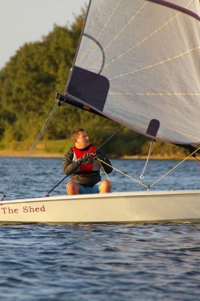

Pop down to your local sail loft and buy an off-cut of 'Sail Number' material - I used it to patch up my old Vareo sail and didn't expect it to last for long but it was excellent and lasted for ages. Just cut a suitable shape and apply it to both sides of the damaged area as per below:
